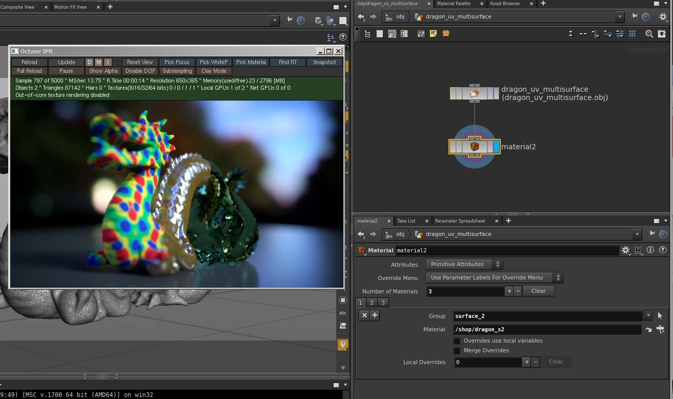

The material SOP node should work to add Octane materials at group level, as you can see in this example. Can you send to me a sample scene with this problem?
-Juanjo
