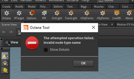

GermanAggie18 wrote:actually, the mis-spelling is correct I'm a bit of an idiot and my programs folder on my second hard drive is progams
# Houdini Environment Settings
# The contents of this file are read into the environment
# at startup. They will override any existing entries in
# the environment.
# The syntax is one entry per line as follows:
# VAR = VALUE
# Values may be quoted
# VAR = "VALUE"
# Values may be empty
# VAR =
# Example:
# HOUDINI_NO_SPLASH = 1
# GAMES DEVELOPMENT TOOLSET
HOUDINI_PATH = $APPDATA\SideFX\GameDevToolset\17.0\1.110;&
PATH = $APPDATA\SideFX\GameDevToolset\17.0\1.110\bin;$PATH
# OCTANE SETUP
HOUDINI_DSO_ERROR_2
PATH = "D:\Progams\Octane_4.04.0.2_Houdini_Win64\Octane_4.04.0.2_Houdini_17.0.506_Win64\bin;$PATH"
HOUDINI_DSO_ERROR_2
HOUDINI_PATH = "$APPDATA\SideFX\GameDevToolset\17.0\1.110;D:\Progams\Octane_4.04.0.2_Houdini_Win64\Octane_4.04.0.2_Houdini_17.0.506_Win64;&"
PATH = "$APPDATA\SideFX\GameDevToolset\17.0\1.110\bin;D:\Progams\Octane_4.04.0.2_Houdini_Win64\Octane_4.04.0.2_Houdini_17.0.506_Win64\bin;$PATH"
