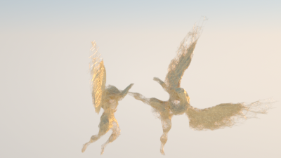

Postby Shizlock » Thu Jul 11, 2019 6:54 am
Shizlock Thu Jul 11, 2019 6:54 am
Having a problem rendering an Image sequence from the octane rop. I am trying to render the image above as a sequence. When I render it in the ipr it works fine for a still image but when I try to render it out as a sequence all I get is the sky background nothing else. I am using the path
$HIP/render/$HIPNAME.$OS.$F4.exr. can you explain what I am doing wrong. In the octane tab I have the render as curve/ fur object turned on but this seems to work only in the ipr. why is that?

Postby juanjgon » Thu Jul 11, 2019 9:22 am
juanjgon Thu Jul 11, 2019 9:22 am
I'm not sure what could be the problem. The IPR and the final rendering to disk are the same, unless there was a problem with the motion blur while rendering sequences or something like that. Have you tried to render the scene in "Full Scene Reload" mode?
In any case, if you want to send me the scene, I could take a look at it here.

Postby Shizlock » Fri Jul 12, 2019 12:16 am
Shizlock Fri Jul 12, 2019 12:16 am
https://drive.google.com/open?id=1_p_7x ... 2kB105ryva here is the scene file. Not sure what "Full Scene Reload" mode is , but here have a look.

Re: Curves in a rendered sequence
Postby Shizlock » Sat Jul 13, 2019 10:12 pm
Shizlock Sat Jul 13, 2019 10:12 pm
actually the Full Scene Reload worked. I guess that was the problem. Thanks for the help, much appreciated.
