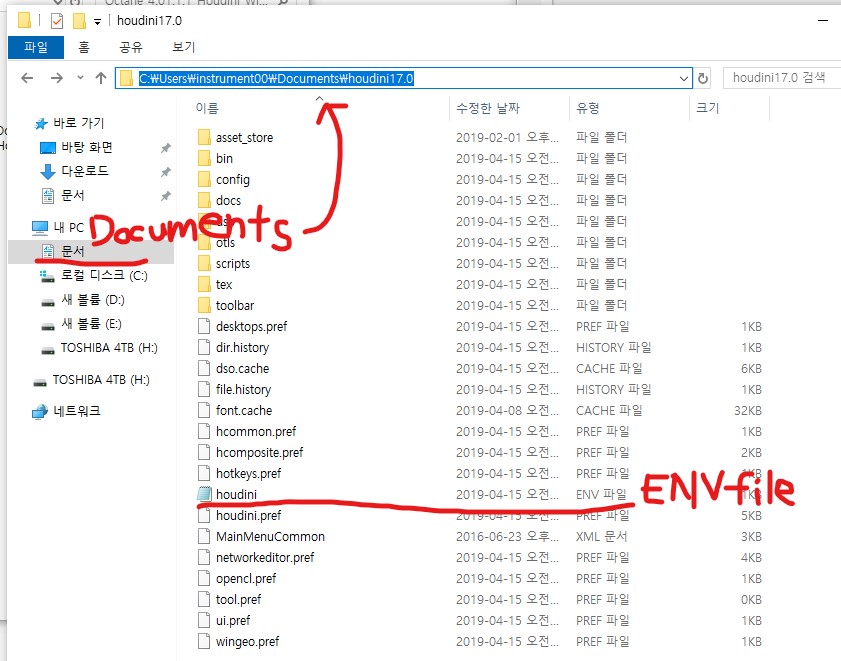

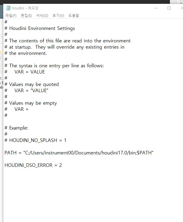

ENV file description was like this.
my documents location is here.
Please help me...
