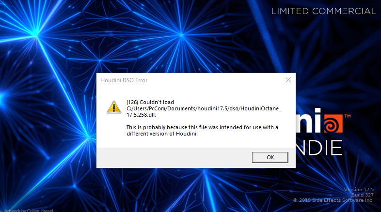

I suspect the path of my .env is correct, since I see an octane shelf in Houdini.
The issue might be with versions. I just installed Houdini 17.5.327
This is the octane plugin I got installed
https://render.otoy.com/customerdownloa ... n64_vr.zip
I get this message when opening Houdini
Thanks in advance for your help.

Hmm, but what plugin build are you trying to use with this latest Houdini production build? Inside the .zip file, there are plugin builds for several Houdini versions. You should try to use the plugin build for the latest Houdini version available, but if it doesn't work, I'm afraid that you are going to need to install the proper Houdini version for it.

I installed the 17.5.229 plugin and I'm running Houdini 17.5.327
Thanks for your help.

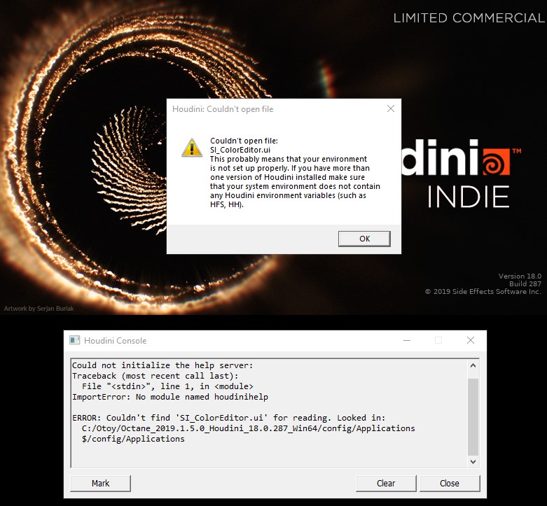

Got the same issue...Using H18.287 , tried both 2019 and 2020 versions...still no luck.
