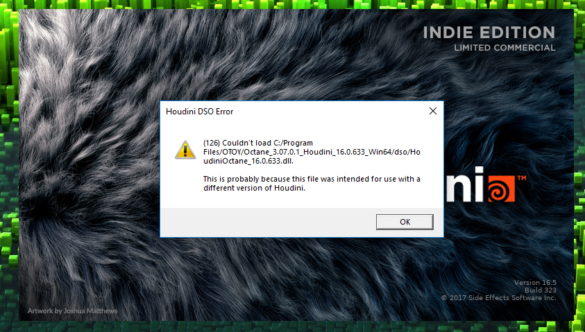

I have bought Houdini indie :-) version 16.5.323 and I have installed Octane for Houdnini "Octane_3.07.0.1_Houdini_16.0.633_Win64" but I get this error...
Waht version of Octane should I use?

The Houdini version and the plugin version installed and pointed by the PATH and HOUDINI_PATH variables must match. If you have the "Octane_3.07.0.1_Houdini_16.0.633_Win64" plugin installed in your HD and configured in the houdini.env file, you must download and install Houdini 16.0.633 to work with it.

More related information. The current Octane 3.08 test build has a proper plugin build for Houdini 16.5.268.
You are working with the latest Houdini 16.5.323 production build, but the current plugin for the 16.5.268 should work fine on it, so after installing the 16.5.268 plugin build on your HD, if you configure your houdini.env file adding these lines, it should work fine:
Code: Select all
HOUDINI_DSO_ERROR = 2
PATH = "C:/Program Files/OTOY/Octane_3.08.0.0_Houdini_16.5.268_Win64/bin;$PATH"
HOUDINI_PATH = "C:/Program Files/OTOY/Octane_3.08.0.0_Houdini_16.5.268_Win64;&"

It worked :-) I`m soooo happy!!!
