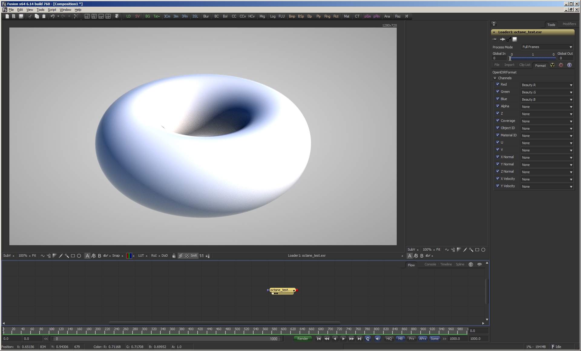

Are you using the multi-layered EXR files feature? Perhaps After Effects has some problems with it. In Fusion the multi-layered file is working file, but perhaps in AE there is some kind of problem. Can you please test the not multi-layered EXR file output?

thanks, yeah it works with standard png and exr. even houdini compositing network didnt show the multi layer file for me, but ill work like this for now its ok.
I will check it in fusion to know if theres somethnig im doing wrong when i get a chance
