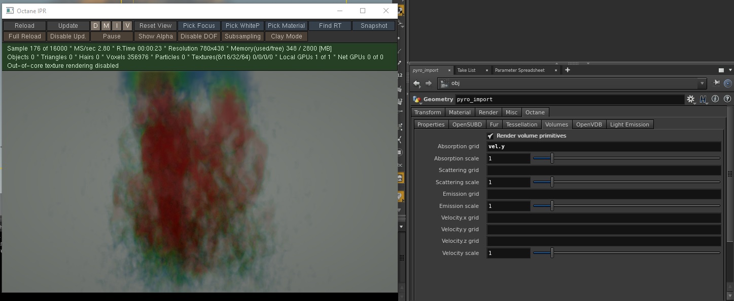

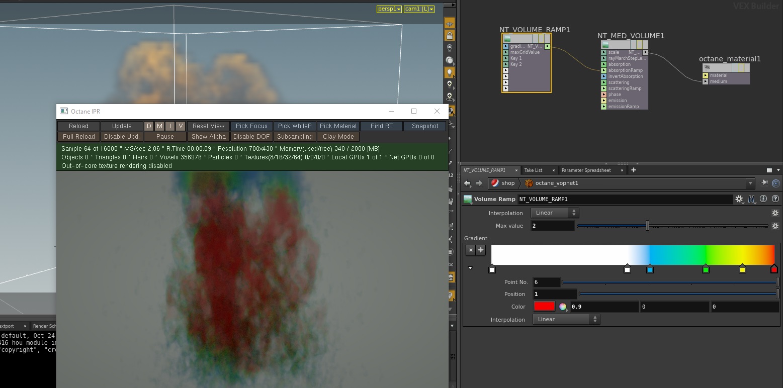

Well, you can now shade any volume grid using a ramp, but the main problem is that the velocity is a vector grid with three components, and the density is a scalar grid. Attached you can see how I can visualize the vel.y component using false colors, but the problem is that this is not the full velocity magnitude ... if you need this feature, I could add an option in the plugin to compute the velocity magnitude from the three velocity grids vector, to use them in the scalar grids.

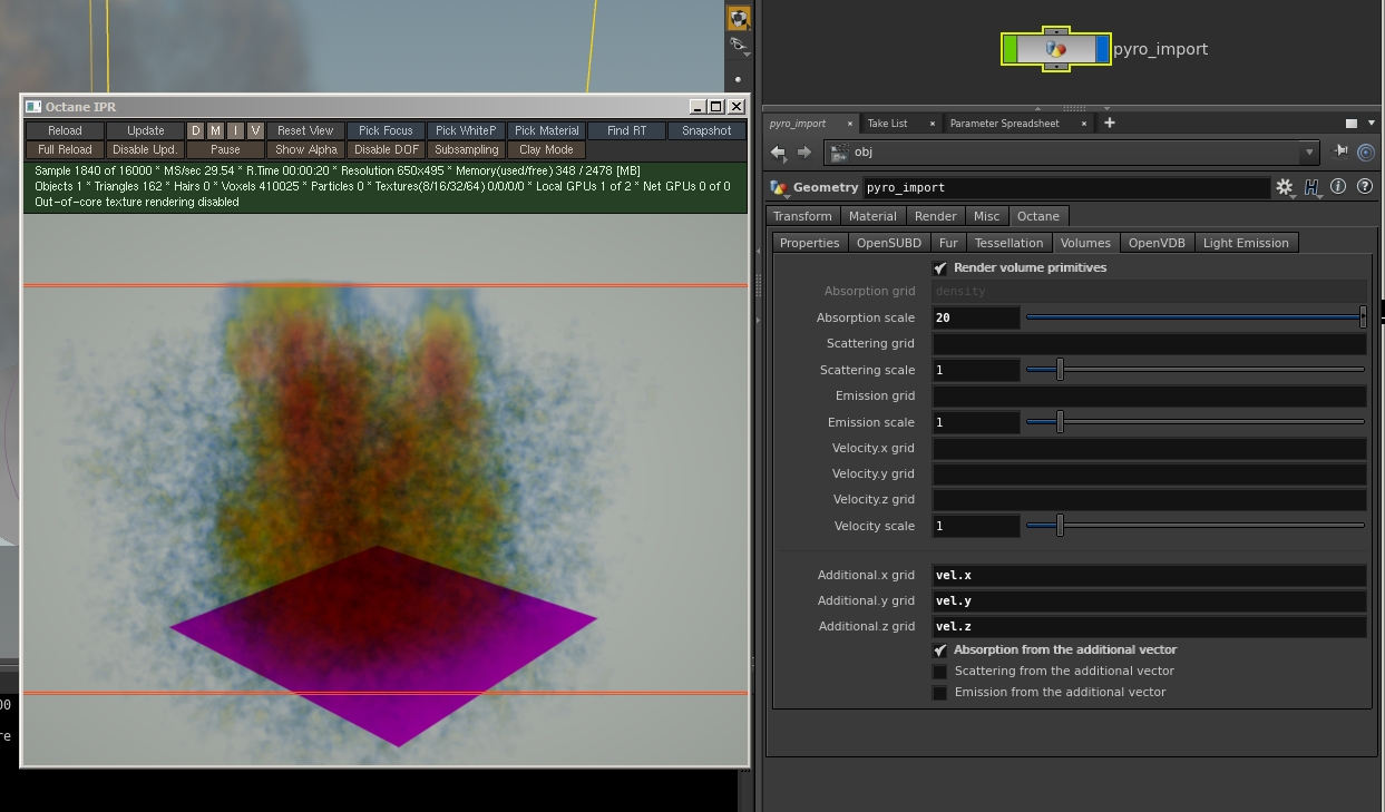

In the next build you will have some new parameters in the volume options tab to set an additional vector grid (the velocity or other) and use the vector magnitude values to fill the absorption, scattering or emission grids. I hope this helps.
