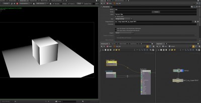

				Guys, Can you do it?
I think,
what need to add string option input texture node,
where we can write a path to img context
in VEX example for understanding my question

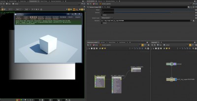

				The problem is that Octane always reads the textures from image files at scene extraction and loading time, so this kind of operators are not going to work. Perhaps you could try to output your ramp texture to a physical file (a bmp or jpg file, for example), that the Octane texture image node can read.
Anyway let me check if for the future I could add some kind of rasterization node to import in Octane image data available from other Houdini image operators.
