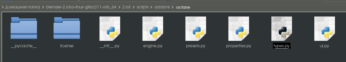

don`t work

kaiwas wrote:don`t work
Do you have the "types.py" file in Octane addon folder? It seems that it is missing for some reason... Check it please.
JimStar
Posts: 3782
Joined: Thu Jul 28, 2011 8:19 pm
Re: OctaneRender™ for Blender 1.20.2 - 1.3 beta Linux x64 [T
Postby JimStar » Wed Aug 28, 2013 8:22 am
JimStar Wed Aug 28, 2013 8:22 am
And are you sure that you run it from the right installation?.. As I see the folder name is "blender-2.68a-linux-glibc211-x86_64", perhaps you have mixed the two blender versions, plain 2.68a and Octane edition 2.68 somehow?..

Postby kaiwas » Wed Aug 28, 2013 8:26 am
kaiwas Wed Aug 28, 2013 8:26 am
Yes. It is present. Files are aligned with the subject of the directory tree.
Thank you! The problem in this
UPD/ 2.68 does not solve the problem
UPD2 / Blender from the source archive is also not start. therefore combined the two "versions"
