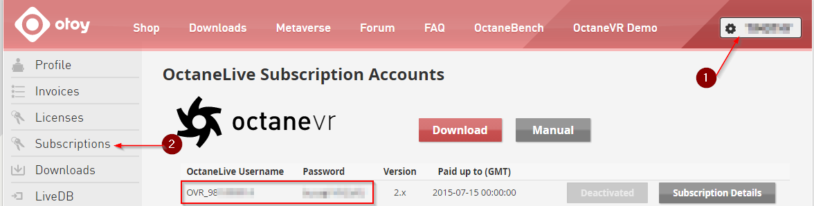

Make sure you are using the subscription credentials from the account area to activate OctaneVR:

Thanks that helped again. There is a strong chance you are helping where there is user error involved here.
I like what you are saying. The streaming demo uses X.IO and OVR . I just ran it on my laptop in a browser so I know that works.
"The OctaneVR download is for the same program that is streamed via X.IO."
I just downloaded the OVR from the non subscription license holder web page you offer
I deactivated my standalone
Launched OVR trial and entered the subscription details from the account areas you showed below. Success!! :D
