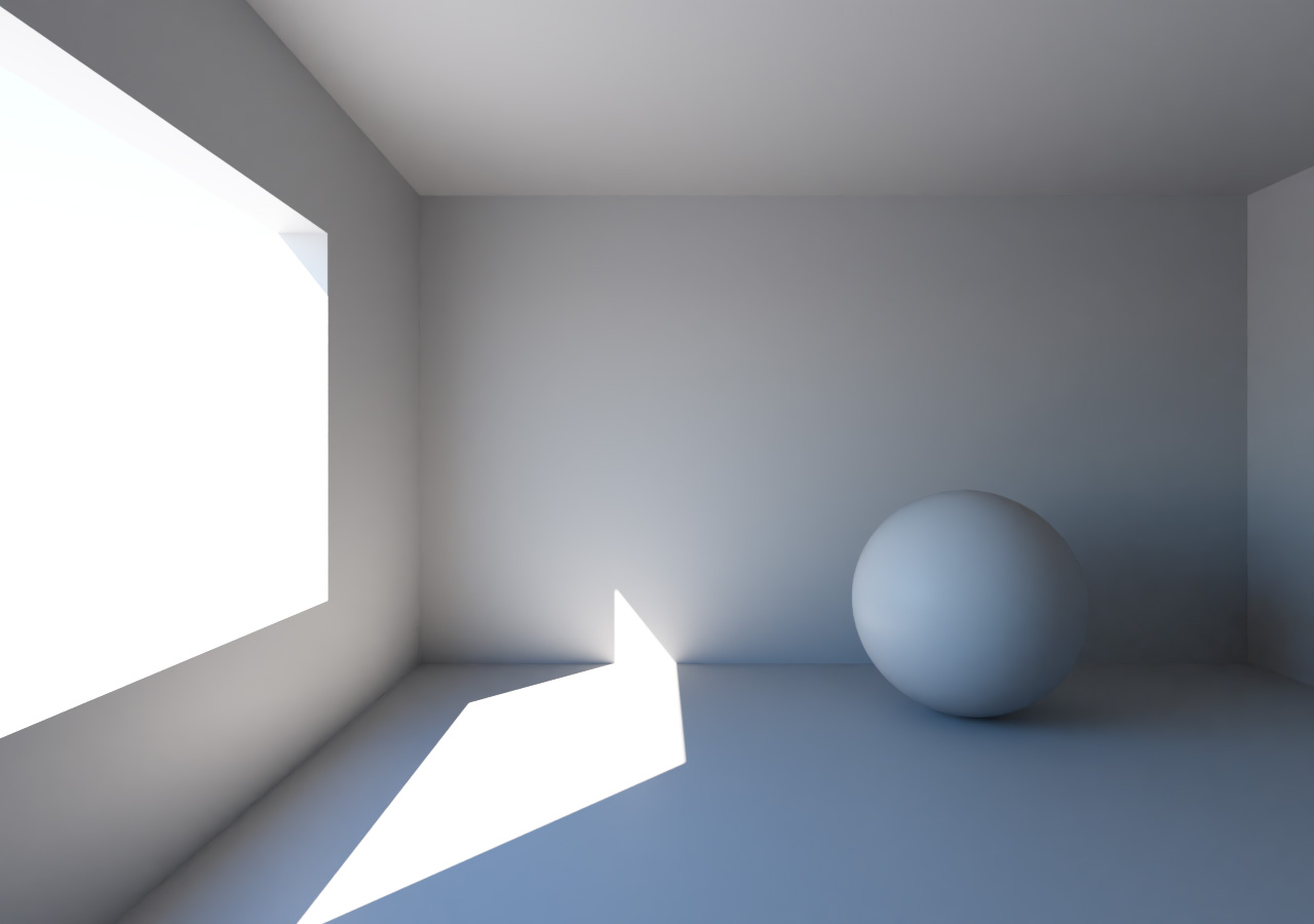

let's say i have a simple room with a sphere in it. if i render the room i have this:
now i add a 'cube' which casts shadows on the sphere:
how do i render only the shadows that are cast by the cube?
i tried the Render Layers BlackLayerShadows and LayerShadows but i get this, which looks like the walls of the room are being ignored?:
i should be getting something like this:
am i going about this the right way?
how do i get a shadow pass like the last image?

i have attached a simple scene. is it possible to isolate the shadow made by the sphere?

Postby Hesekiel2517 » Wed Aug 30, 2023 9:25 am
Hesekiel2517 Wed Aug 30, 2023 9:25 am
I'm also wondering how to do that. Can't disable self shadowing of my shadow catcher. Any suggestions how to do that?

Postby Hesekiel2517 » Wed Aug 30, 2023 9:32 am
Hesekiel2517 Wed Aug 30, 2023 9:32 am
Ah found it. You have to tick shadow catcher in the material. In my opinion it should work without doing that, but at least it works

Postby Hesekiel2517 » Wed Aug 30, 2023 9:47 am
Hesekiel2517 Wed Aug 30, 2023 9:47 am
i just want to add that this works, but disables the layer reflections. So mybe there is room for improvement
