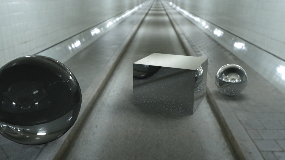

With red color applied to the matte diffuse color:

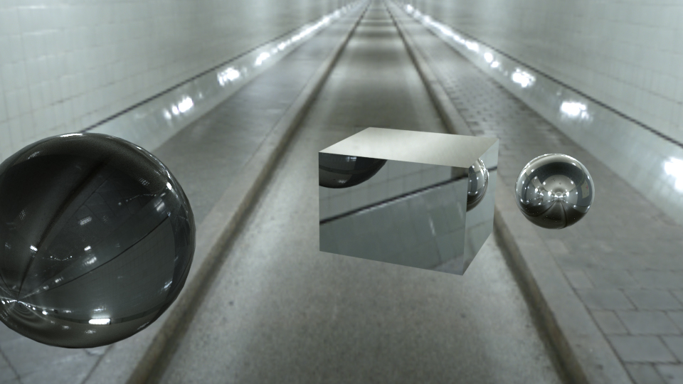

With the projected color:
													Shadow Catcher and correct reflections -> here you go

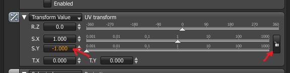

Is it somehow possible to mirror file texture nodes directly with octane?
						Added more self-explaining Images.
- dionysiusmarquis
- Posts: 159
- Joined: Mon Nov 04, 2013 9:29 pm
I see, thank you. I was in Maya and there the transform restricted the input to min 0.0001. But in Standalone it works flawlessly!roeland wrote:You can change the UVW transform like this: first disable the aspect ratio lock on the right, then set the S.y (vertical scale) to -1. You can do this by clicking in the text field on the left of the slider.

I must confess the title is misleading. But the text should make it clear. This approach is more common as a background Image/hdri combination. The goal is to render a glossy Object into an 2D image with plausible reflections and refractions. This is achieved by projecting the background image or like in this case the hdri onto 3D objects. Theoretically its possible to convert the 2D image to 3d with this method quite well. In this example only the floor of the hdri is projected to 3d onto the matte plane. You can also find more about it under the term camera mapping.

Here is the same without the matte plane object (notice as it doesn't fit anyhow into the environment even if you would put in shadows):
