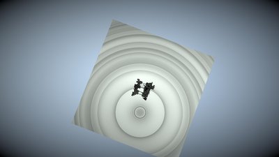

can anyone explain what these streaky lines are? What caues them and how do i get rid of them?
thanks in advance
Marc
unwanted lines

this happens on extreme scales. i guess this is not the final shot, isn't it?
if you get closer to the objects in the center, this artifacts should disappear. you might also check your general scene scale (mind the meter unit in octane!) and apart from that you may need to adjust the ray_epsilon value in the kernel to match your scene dimensions...
