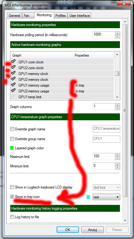

smicha wrote:@ Rappet: download msi afterburner - best soft to monitor your gpus (also temps for cpu). Go to settings, choose a desired card and watch the scores - see the screenshot.
Yes.. now I remember what I wanted to do.. thanx for the tip. I am already downloading ;)
smicha wrote:PS. Great results for Z - so I must overclock by about +200mhz to get on 2x780 what you have on Z. Just give my the core clock and if it is about 900mhx it means we have a pretty potential room for overclocking at stock volts. So please pass core clock.
I got @ 940-980mhz core (where can I see the mhz mem :?: )

Go to monitor tab - mark desired stats - see the screenshot.
