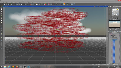

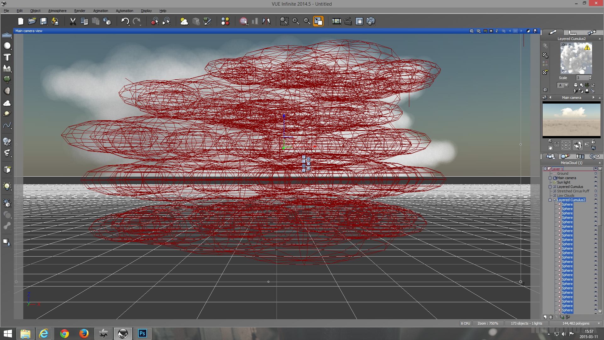

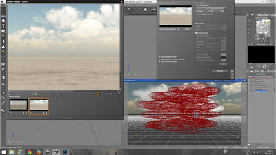

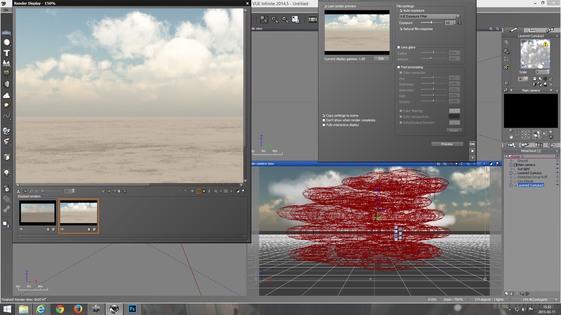

To illustrate some images how it is done in e-on vue:
In the example above:
For each e-on vue spherical based metacloud we would need about 25-100 volumetric based stacked spheres in OctaneRender...
And as profbetis allready pointed out in his original thread more than 25 layers is going to slow down render speed massively.
The problem in practice may be that most systems will not be able to handle it.
So for now I can live with the flat cloud bottoms.
It still looks amazing and I am looking forward to the next Phantom Scatter update!
Thank you for your work!!
