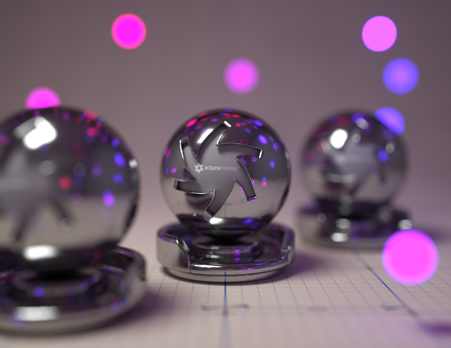

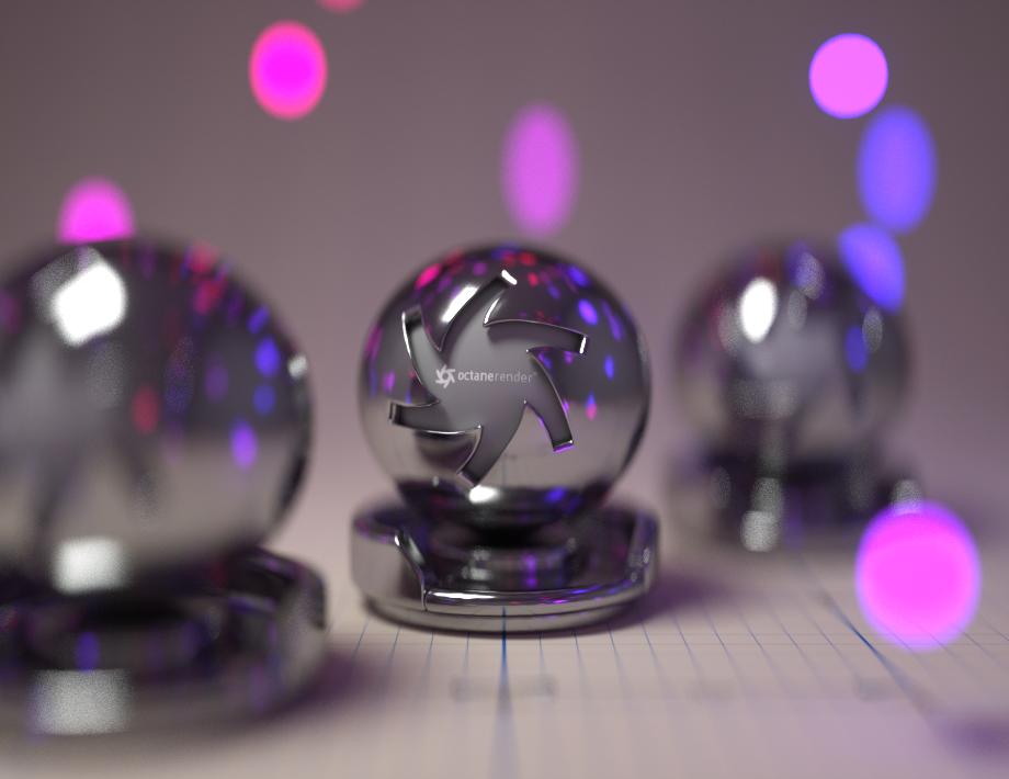

I just wanted to post a little update now that anamorphic style bokeh controls have been added in the 2.22 update. It's too soon for the MODO plugin to have been updated yet, so I created the sample scene in MODO then exported the ORBX to Standalone. Just a standard chrome render ball with some scattered glowing balls around it.
Aperture Aspect Ratio: 1.0 (spherical bokeh)

Aperture Aspect Ratio: 2.0 (anamorphic bokeh)
As you can see, what's barely out of focus is barely stretched and what's quite out of focused is quite stretched. It also effectively decreases the DoF of the scene. Overall, I like it. I think perfectly round glowing shapes becoming perfectly elliptical glowing shapes might not be very realistic, I like what it does with the highlights on the chrome render ball. Maybe a bit of aperture edge and you've got something useful.
The only thing I've noticed is that the samples calculating the blurred points of the image are now stretched further apart, so it takes longer (more samples) to get a grain free image with anamorphic bokeh. I didn't go for grain free in the above images — both were rendered to 2000 samples for ~6min. — but you can still see the grain is more noticeable.
Edit: I noticed something else I didn't see before. At the top edge of the anamorphic image, you'll see a pink blur coming into the frame that isn't in the spherical bokeh image. This is good news because it means the aperture aspect ratio control sees blurred surfaces outside the camera frame, unlike some other compositing effects that only operate on visible pixels.
