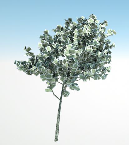

Just wanted to create some simple trees for use in Sketchup, and found this nice and simple generator tree[d] https://web.archive.org/web/20130915030 ... reed.about.
I have exported as OBJ, and used Content Menu > Octane Proxy > From .obj and imported into Sketchup. It all works fine, but the alphamap on the leaves. Can anyone see if there is something wrong the .png image?
I hoped to be able to use the exported .obj file without involving other programs.

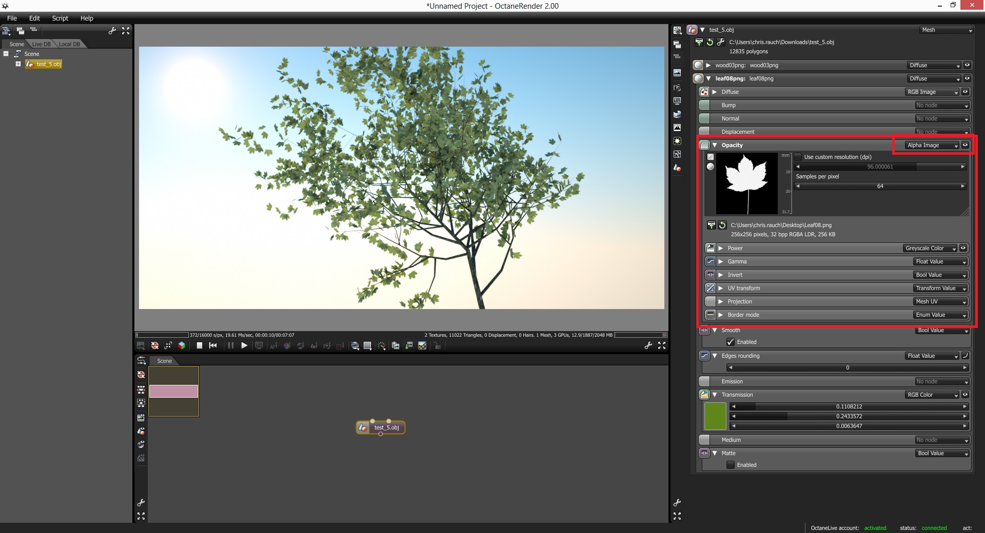

The .mtl file does not have the listing for the opacity map.
It needs a line:
to specify the opacity map.
If you manually edit the file to:
newmtl wood03png
Ka 1 1 1
Kd 1 1 1
Ks 0 0 0
newmtl leaf08png
Ka 1 1 1
Kd 1 1 1
Ks 0 0 0
ie: add the map_d parameter for the leaf material, then the standalone at least will pick this up and just work.
So it's a problem with the obj generator, it needs to add this "map_d" line to specify the opacity map (maybe there are some settings you can change that will make it do it?)
Attached is a zip of the tweaked version that should work (obj, mtl and textures).

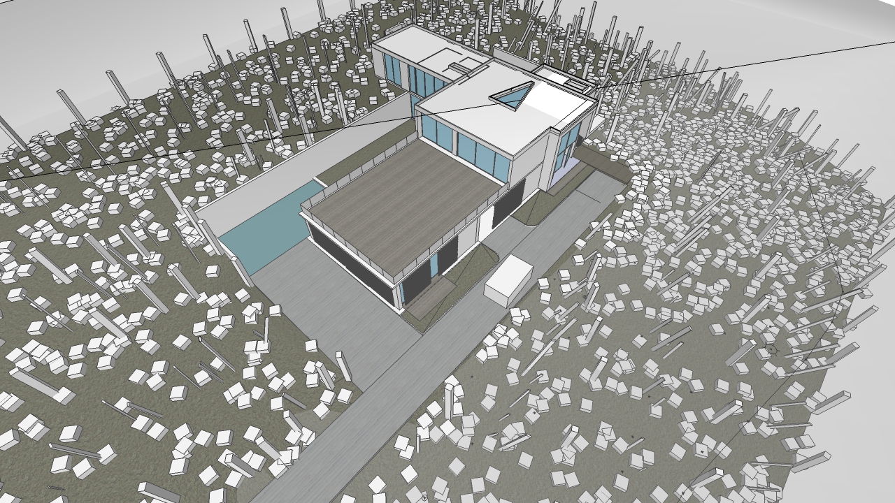

Hello Jorgensen I think you are misunderstand the proxies option inside Octane4Sketchup.
Sketchup cannot open/import .obj files.
But Fuzzy gave us the option to say to Sketchup that a lowpoly component that we have in the model can be read as a highpoly .Obj or .Ocs file inside the Octane Viewport.
Its not possible to SU to edit a .ocs or .obj file, it is only reading them inside the render engine.
To be able to use all the potential of this proxies system you need to create your library of models. For example this tree you created, you cannot open the .obj file inside Sketchup and edit the materials, its not possible. After creating your new tree open Octane StandAlone load the .obj file, aply the materials, save as a Tree.ocs then in Sketchup you select a component that you have in your model and choose "proxie" -- "from OCS", select your file and in the OctaneViewport you will see the tree that you edited inside Octane StandAlone.
has you can see in this example:
cheers
resmas
