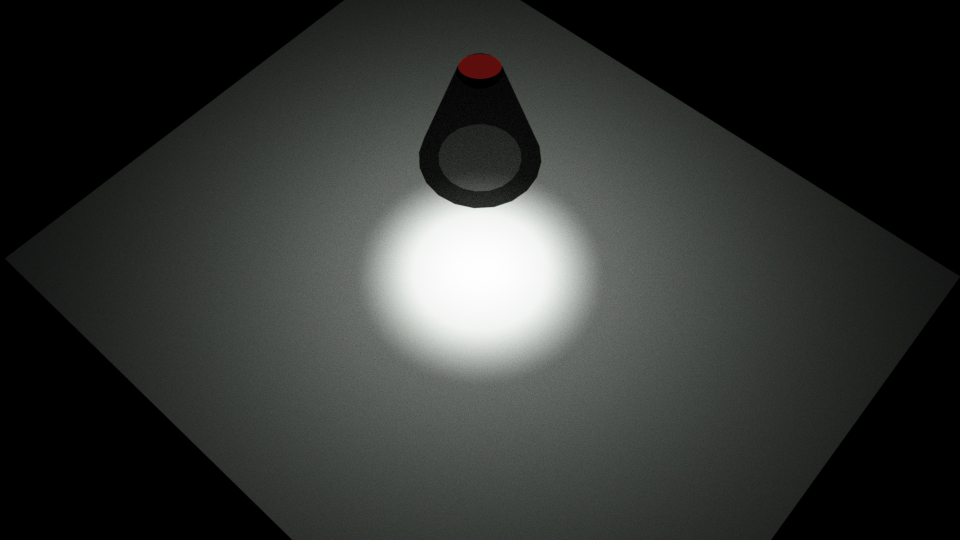

Nice idea. I tried to reconstruct a spotlight. To get hard light edges you just need to decrease the light source size. WIth a cone and some booleans I got this (I marked the light source red and made the cone transparent to show the hole):
Edit: The Spotlight radius increases with light smoothness even when the distance of the cones bottom and light source is consistent. The cone setup can be much simpler: Just keep the cone open at the bottom and control the cone radius to change the spotlight radius (no resizeable hole needed).

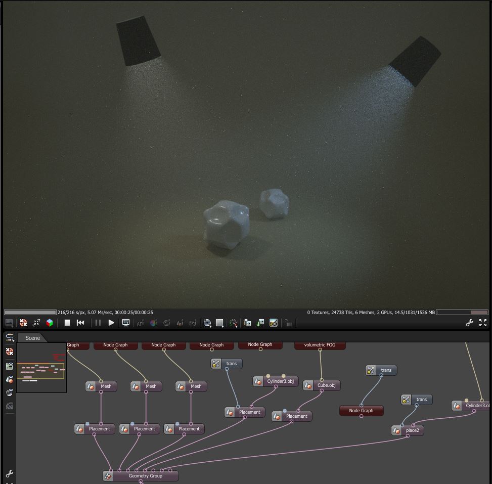

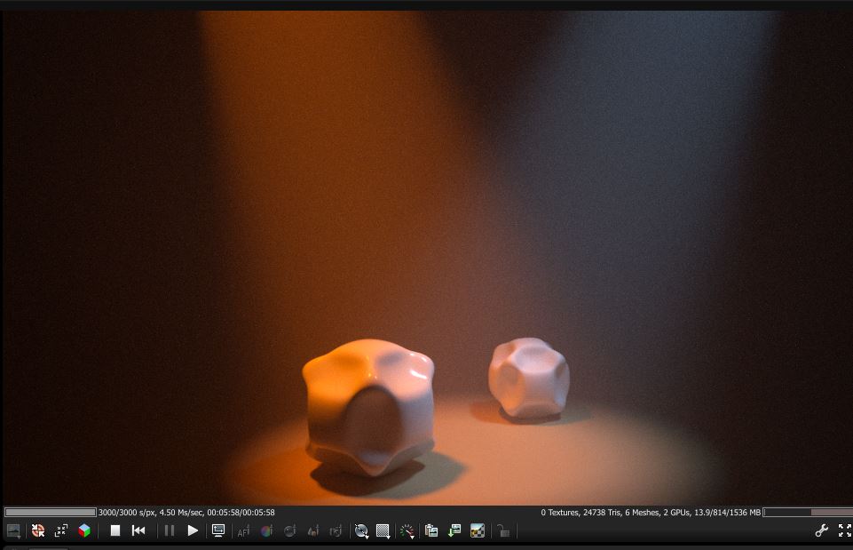

Will be a part of upcoming script.
Hollywood
Hollywood
MeshLights
MeshLights

Tht looks like a great solution.
