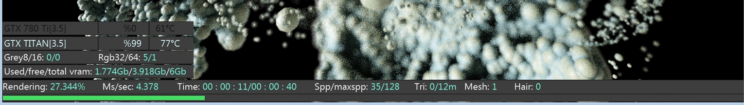

hi,
it seems that the new version needs a lot more memory for geometry.
this is a huge alembicfile with aprox. 12 Million tris.
version 2.21.1 uses 1.774 GB
Version 2.22.1 uses for the same setup 2.672 GB
alembic_file:

Posts: 16068
Location: Türkiye
useruser wrote:hi,
alembic_file:
https://dl.dropboxusercontent.com/u/14397672/8.rar
hi, could you post on Standalone topic also? This is not caused by plugin. Otoy guys can reply about this.

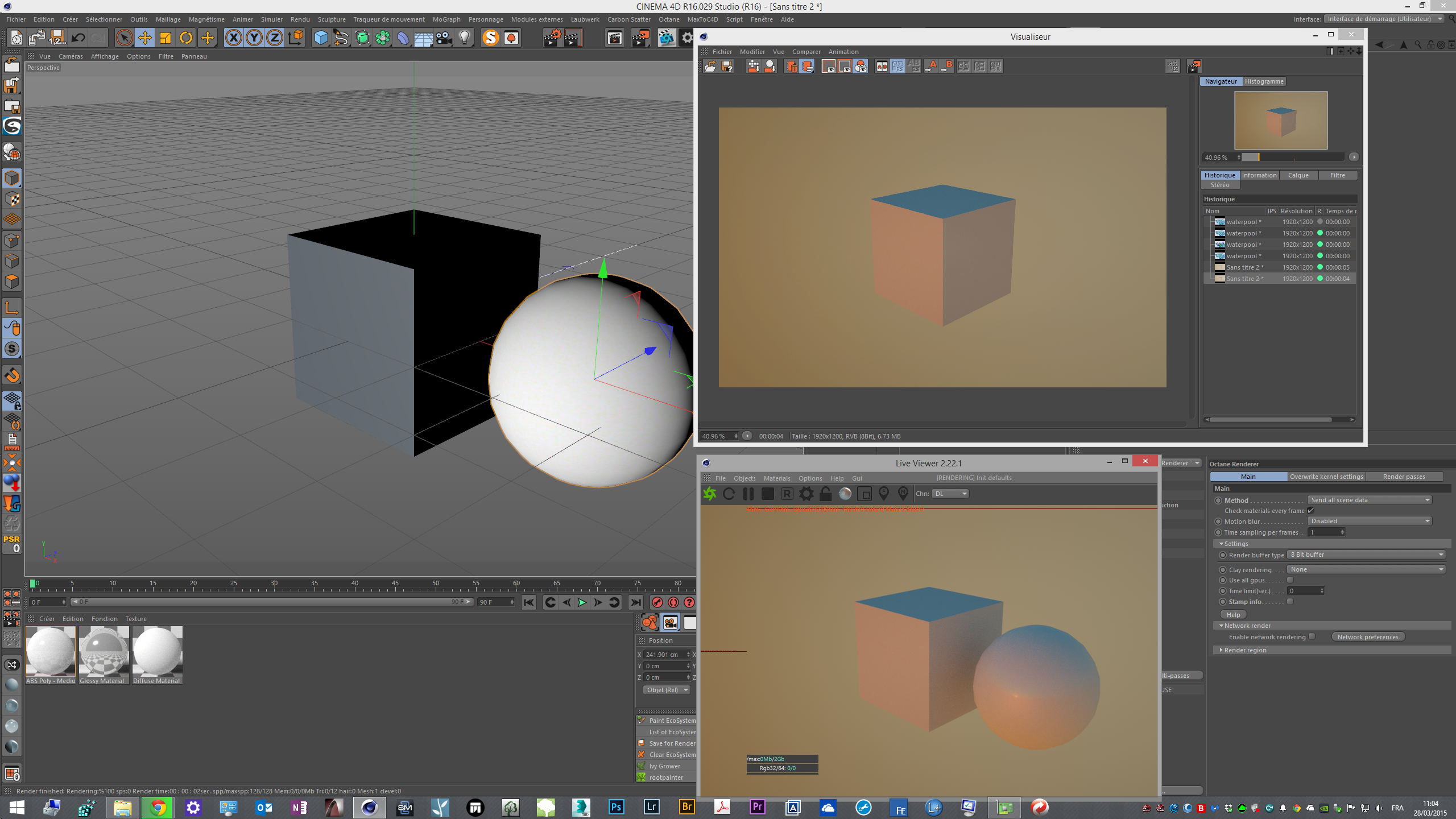

Hi
Missing primitive sphere on rendering picture viewer
good display with octane live viewer window :ugeek:
I think if you tick off perfect sphere in the attributes it will work as a workaround!
