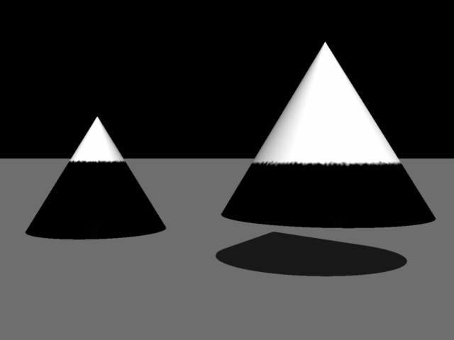

I would like to develop a LUA nodegraph that could create a texture based on the 'height' of a mesh. It is basically a Boolean shader used to drive a mix node and draw a line at a certain distance along the x, y, or z axis. This could be in local or global space. The attached image shows a global elevation shader applied to two object. The objects are five feet high and the elevation is set to three feet. The line is blurred but I would be happy with a straight line.
I just need to know if it is even possible to do this in LUA and, if it is, some direction to get started.

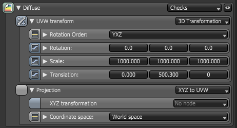

You can use a checker board texture and apply the appropriate scaling. By default the checks are 1 unit wide and the origin is in the centre of a square.
Set the coordinate space to world space, and then set up the UVW transform:
First scale the checkerboard up so the entire scene fits into one square: set the scale to something like (1000, 1000, 1000)
Then on the Y axis you have to move the border of the checkerboard up to where you want it. By default the border now is at -1000/2, so move it up by (1000/2 + Y). Of course you can do this with a script inside a scripted node graph.
The scale value on the X and Z axes don't matter much as long as it's larger than your scene. On the Y axis it can't be too large, since floating point calculations only have about 7 digits of precision.

Ok, thanks Roland, that's cool. I can work with that.
Sorry to bother again but can you think of a way to add some noise at the transition point of the tile.
