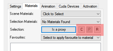

Paul - one other thing. Is it possible to copy an object and have the proxy .orbx or .obj file remain attached? I'm "painting" a surface with trees and it would be really helpful if I didn't have to re-assign a proxy every time I copied, or instanced a Revit object.

Hi Ed - I tried without success to do this some time back. So instead, added the Copy ('C' button), Paste ('P' button) and Replicate ('R' button) next to the proxy button to allow you to quickly copy proxy info between family instances.Is it possible to copy an object and have the proxy .orbx or .obj file remain attached? I'm "painting" a surface with trees and it would be really helpful if I didn't have to re-assign a proxy every time I copied, or instanced a Revit object.

Paul - the increase in the proxy limit works very nicely. Thanks. As far as replicating proxies- can an option be added to the "R" toggle in the materials dialogue box to replicate all information to only selected proxies? That way I could "paint" a bunch of instances, change them all globally, then select a group of families and change the selected properties. In multiscatter I could "paint" instances and it would randomly change the scale, rotation, etc. If I select individual families in Revit and change the parameters of just those instances, it would be the next best thing to having Multiscatter running inside of Revit.

Yes, this should be possible (it's implemented in the ArchiCAD plugin) - it wil ltry to add this to the next release of the plugin.can an option be added to the "R" toggle in the materials dialogue box to replicate all information to only selected proxies? That way I could "paint" a bunch of instances, change them all globally, then select a group of families and change the selected properties. In multiscatter I could "paint" instances and it w
