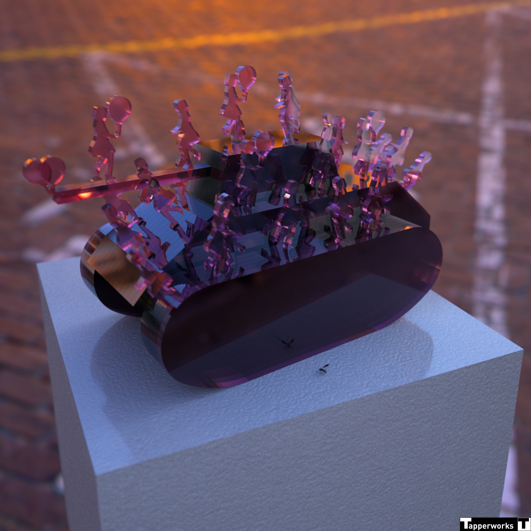

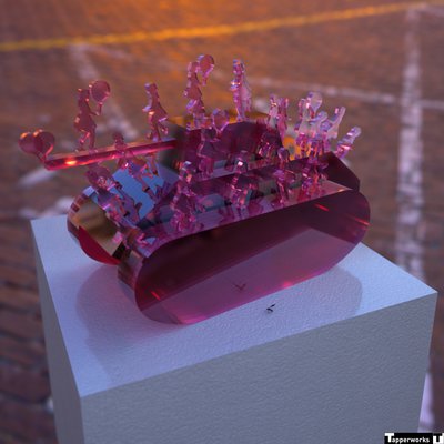

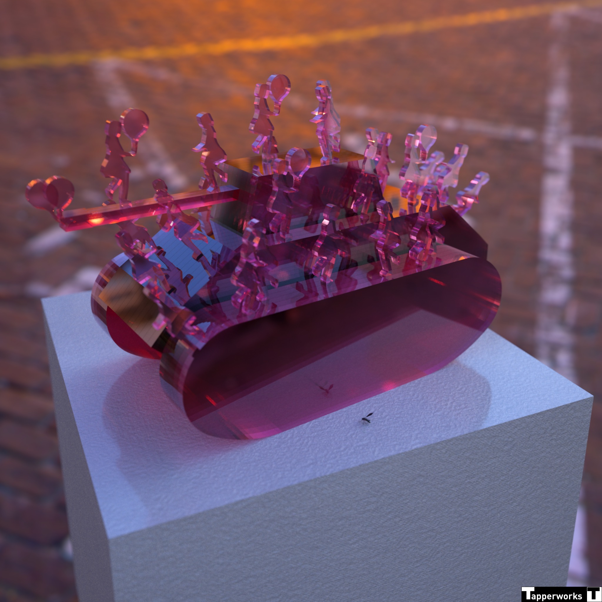

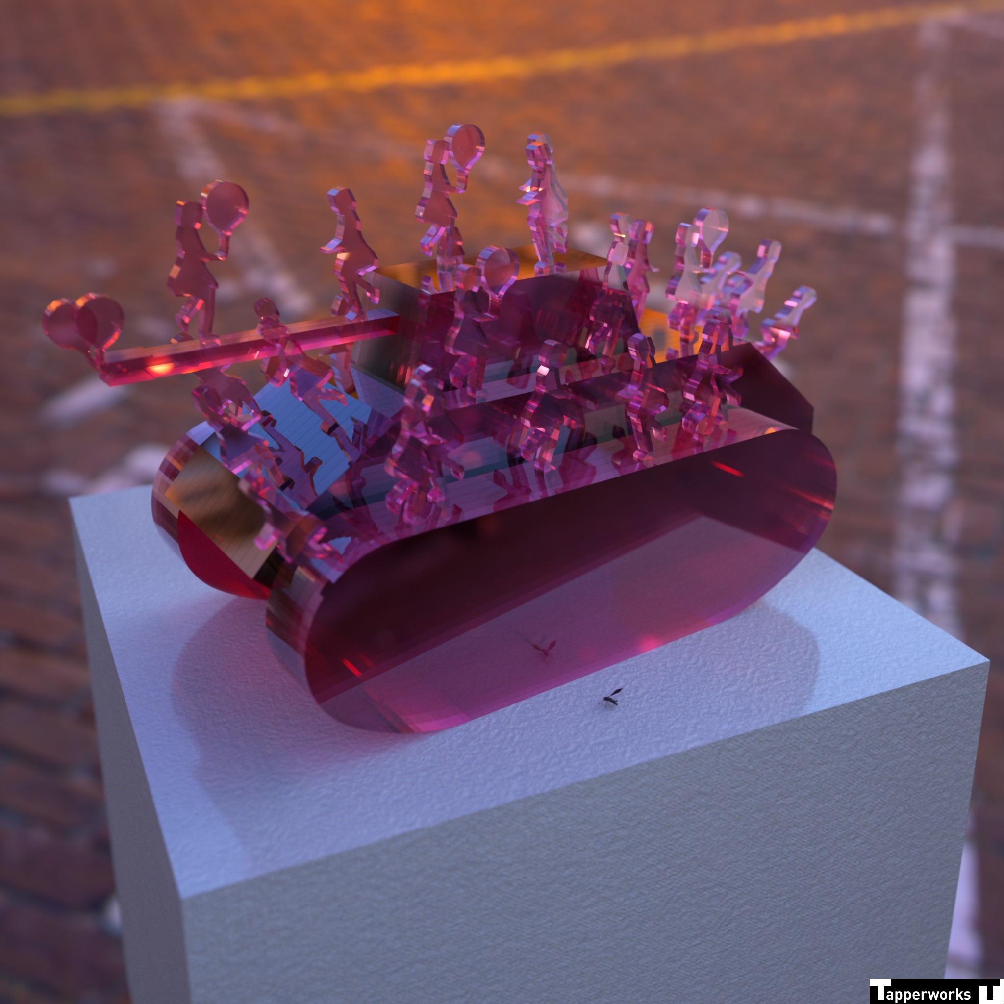

I did some test to see what different result I get with Daylight, PMC and PT kernels.
I only did some little noisereduction in postproduction.
The setup is with hdri background and one white-emitting object from the back of the camera.
The DL does not show the material as well as the PMC and PT kernels.
The material is plexiglas (from DB) and adjusted a little to get the right pink look I was looking for.
I must say there is almost no difference in PMC and PT.
Maybe it is better to test with the same samplerate or rendertime?
(the image names show the samplerate and the rendertime aswell.
Maybe someone has a good idea how I can test better test the kernels with this scene to learn?

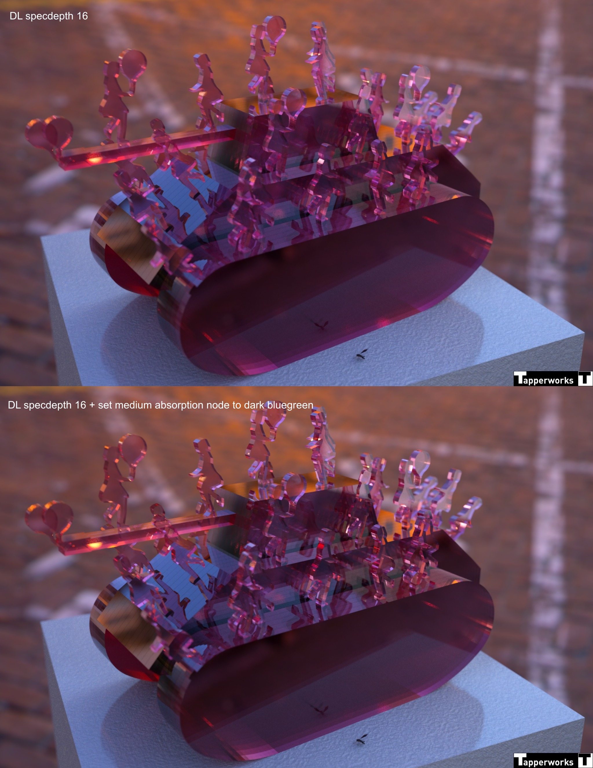

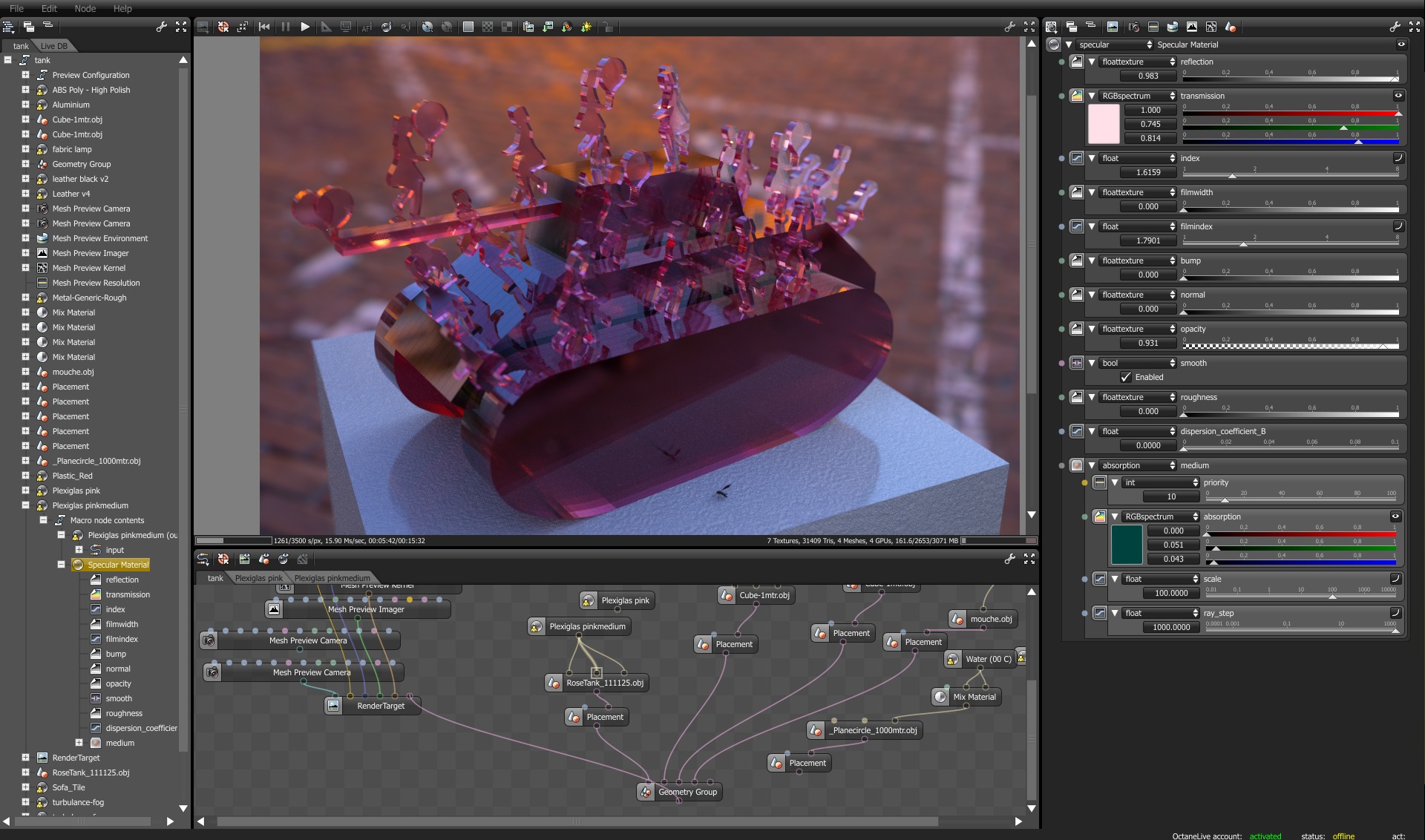

Hi Roeland,
Thanx for your help and explaining.
I did a new rendering with increasing speculardepth from 5 (I think?) to 16, and indeed.. look at the improvement within DL.
I had not tweaked the plexiglas material bij adjusting the medium node, but only by changing the RGB transmission node
and also a few changes in opacity and reflection.

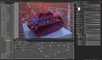

The next step I tried is the medium absorption node and I set it to a darkgreenblue as you suggested.
You can see the settings and results.
