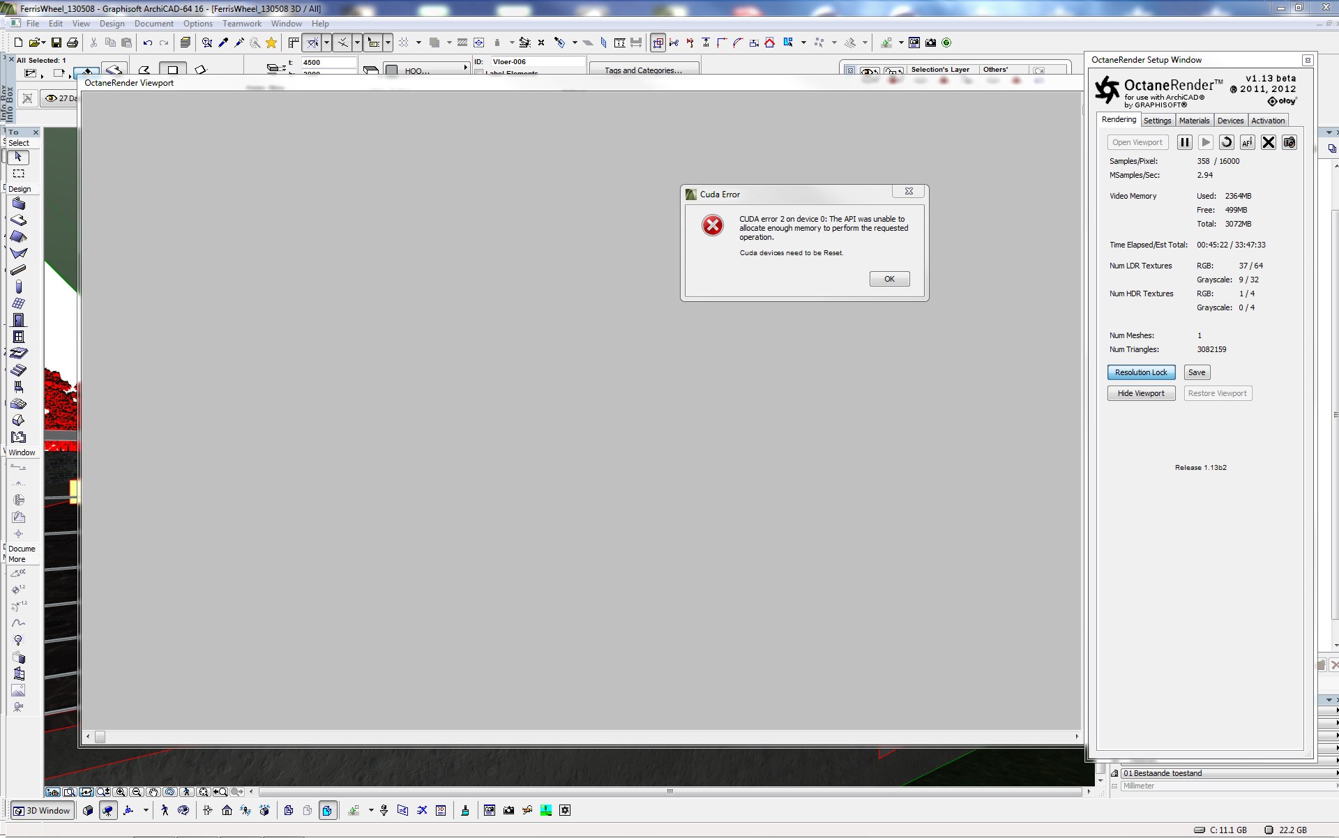

Hi Paul,
While rendering with 3GPU I activated the fourth GPU and doping that I got a cuda eroor and the OR Viewport closed it self?\
And I got the same error restart the window.. it seems to be a memory issue?
Uncheck the GPU I was activating and open OR Viewport it is fine again.
Seems something with just the one GPU, or memory form one GPU needing for system maybe?
Do you have any idea?

Hi Jeroen
If you get the Cuda error from the Octane Viewport (not a photorender), the Cuda Log details should be in the ArchiCAD "Report" - that should give a more specific reason for the problem you are experiencing.
The next version of the plugin will include a "Cuda Log" button on the "Devices" tab which will also give a full report on the Cuda error.
At a guess, I'd say that one card has a smaller VRAM capacity for some reason, so you are running out of memory on that card. Total Octane VRAM capacity is the amount of memory your "smallest" card has - so including that card for rendering is reducing the total memory capacity for the render.

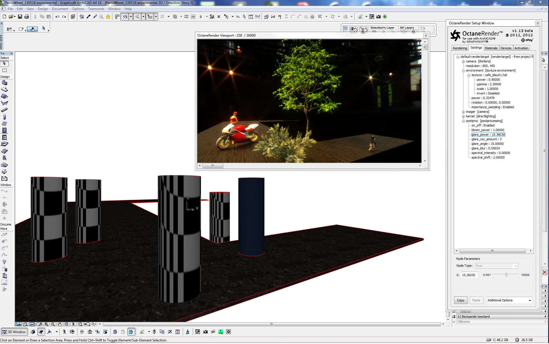

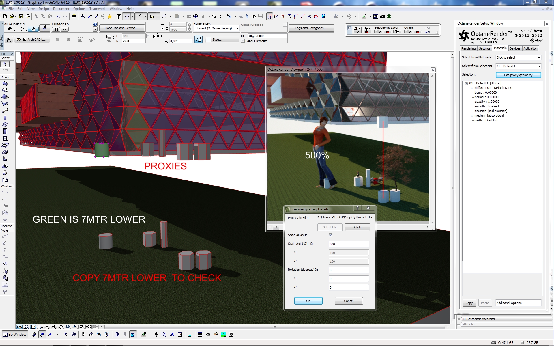

This is fantastic :!: :!: :!:
As you can see I managed easily to link different OBJ's into the PLN,
I tried to scale and rotate one and that works perfectly :D
All links in this file dropped vertically about 7mtrs :?:
I'll test in another scene to see if this will happen the same way.
Greetz, Jeroen
UPDATE: with second scene
In the second scene the vertical placement of proxy is OK.
Notice the Pinguin is out of place, but I think the OBJ is incorrect to begin with :oops:
second scene
second scene
first scene with wrong vertical placement of proxy

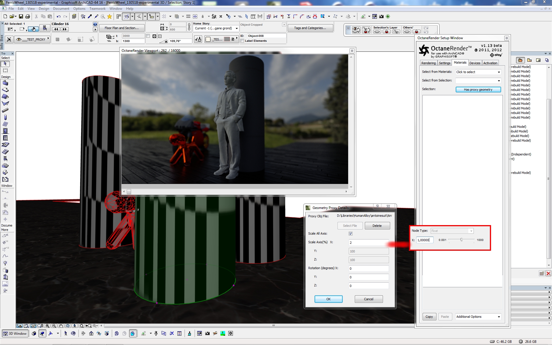

Hi Paul,
Scaling a proxy starts at 1% and next step is 2%.
Some OBJ's are way out of scale and sometimes you might to want to scale objects totally 'weird'-small like inserting a Maquette-scaled city-object.
In my example I tried to scale the human to 1.7mtr (like column height), but the original is totally out of scale,
so I wanted to scale like 1,17 %.
Maybe you planned to this (because this is still in experimental stage), but 1,00000 like other settings might be handy. (example is in red square)
greetings, Jeroen
