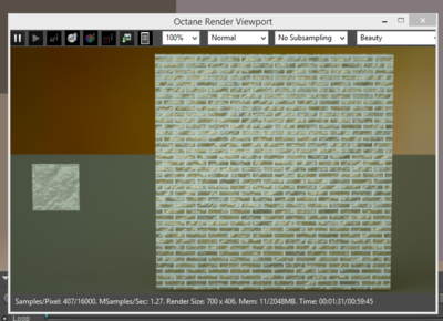

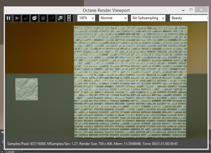

Hi - Poser is providing UV coordinates in the range 0 to 1, regardless of the size of the object - so there is no "one scale fits all" solution. When using Poser testuremaps this is not a problem, but if you use a LiveDb texturemap, there is no way for the plugin or the material to know how big the geoemetry is that it is being used on. For example, if you scale up a Poser Square primitive, the LiveDb texture gets scaled up too. I think that is one of the inherit issues with using LiveDb materials in Poser. A Material tab rightclick option could potentially be provided to allow you to scale all textures for a give material.

Could this work with the Rhino plugin ?
I tried using the Rhino texture mapping to 'master' scale all the sub elements of a material,
but I either don't know how to control this or it doesn't work well with Octane.
