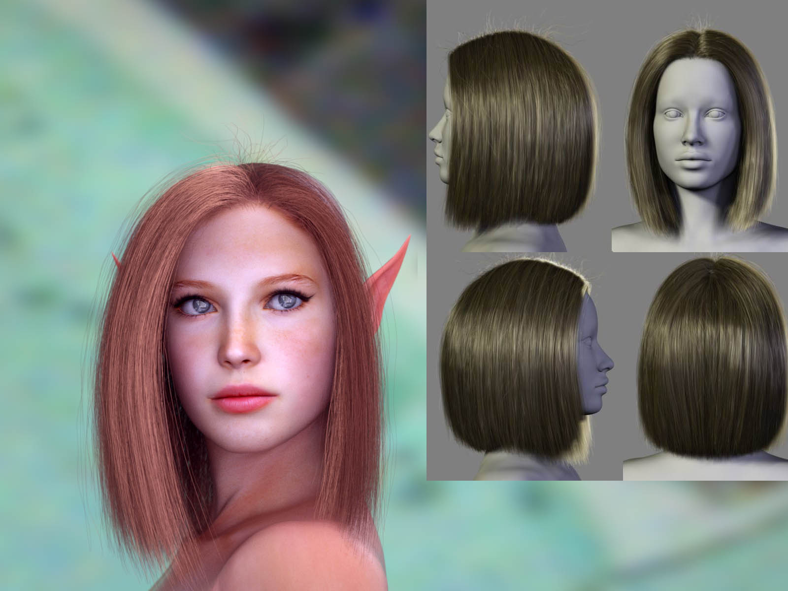

Well I managed to buy hair farm & 3-D studio Max+ plus octane render license the 3-D studio a Max also.
This was my first render with hair farm (rendered in normal scanline in 3-D studio Max)
It looks like it is going to be possible to export it to poser.
I will post my findings later this weekend a Sunday is really only time I can dedicate to this project
W7 64 bit |I7-3970X | GTX 780 X2(6GB) GTX 780TI X2 | 64 GB DDR3 RAM
Real Skin & real hair for Poser / DAZ Studio OctaneRender/iray - coming soon
ch0pper
Posts: 405
Joined: Sun Dec 30, 2012 9:31 pm
Location: uk
Well here are my tests and literally have been playing with this less than 24 hours
Exported the mesh from 3-D studio Max hair farm into an object file format(I have enclosed this so you can play with it yourselves if you wish)
You will need to do two things to do read this
You will need to reduce the size of the object to approximately 20% within poser
You would need to mirror the half of their hair to make a full hair. (As I haven't had time to work out how I actually joined to objects together in is hair farm may be later)
you can download the obj from my server if you wish to play with the test hair
send me a PM here ! and will send you the link
literally the render below is 30 minutes I didn't leave the rendered to complete it probably would be a lot better. Still a lot of shading and SSS to be done to get it perfect.
Also I slapped the object on the hair without any real care so I know the seems on the hair don't actually match but is a test it works that's all I care.

Just an update on where I am with hair farm and outputting it to poser I've had some great results.
This is a very early stage mock up I will post another full-blown picture at the weekend.
But I'm now starting get the colouration and the hair that I wanted
Click on the below picture for blow up version
VVVVVVVVVVVVVVVVVVVVVVVVVVVVVVVVVVVVVVVVVVVVVVVVVVVVVVVVVVVVVVVVVVVVV :lol:

Amazing!
