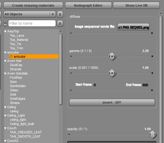

Finally, do you think that movie file or image sequences (PNG most importantly of all) could added as options to texture maps?

orion_uk wrote:Finally, do you think that movie file or image sequences (PNG most importantly of all) could added as options to texture maps?
there is already basic support for this. if you select any image that has a 4 or 5 digit number right in front of the file extension (say grab00001.jpg), then the plugin will try to load images from this sequence according to the current frame number - note, that this update will only happen when rendering an animation via the plugin. better support like offset or loops might come, but has currently low priority since it is not all to complicated preparing a fitting sequence using video editors....
aaahh ok, I did (kinda) try this but not using the render animation option, I just scrubbed through the timeline and rendered the next/current frame and saw no changes..Thank you :D :)
