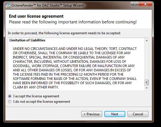

I am also having an installation issue... Windows 7 x64, with MSE turned off running the installer as admin. I'm getting to the second install screen when clicking next and then the installer just quits... no error, no OctaneRender subfolder in my home folder, nothing...

scaron wrote:I am also having an installation issue... Windows 7 x64, with MSE turned off running the installer as admin. I'm getting to the second install screen when clicking next and then the installer just quits... no error, no OctaneRender subfolder in my home folder, nothing...
have you started the installer with "right click > run as administrator"? this might help. another thing might be to lower the windows UAC settings for the time of the installation.
if nothing helps, please send me a pm with a copy of a log file from DS (go to "help > troubleshooting > view log file" and save it somewhere) - this will help me to identify if the installer has a problem with the particular installation or location of DS....
