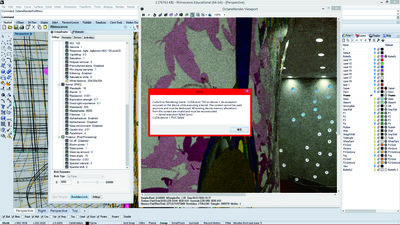

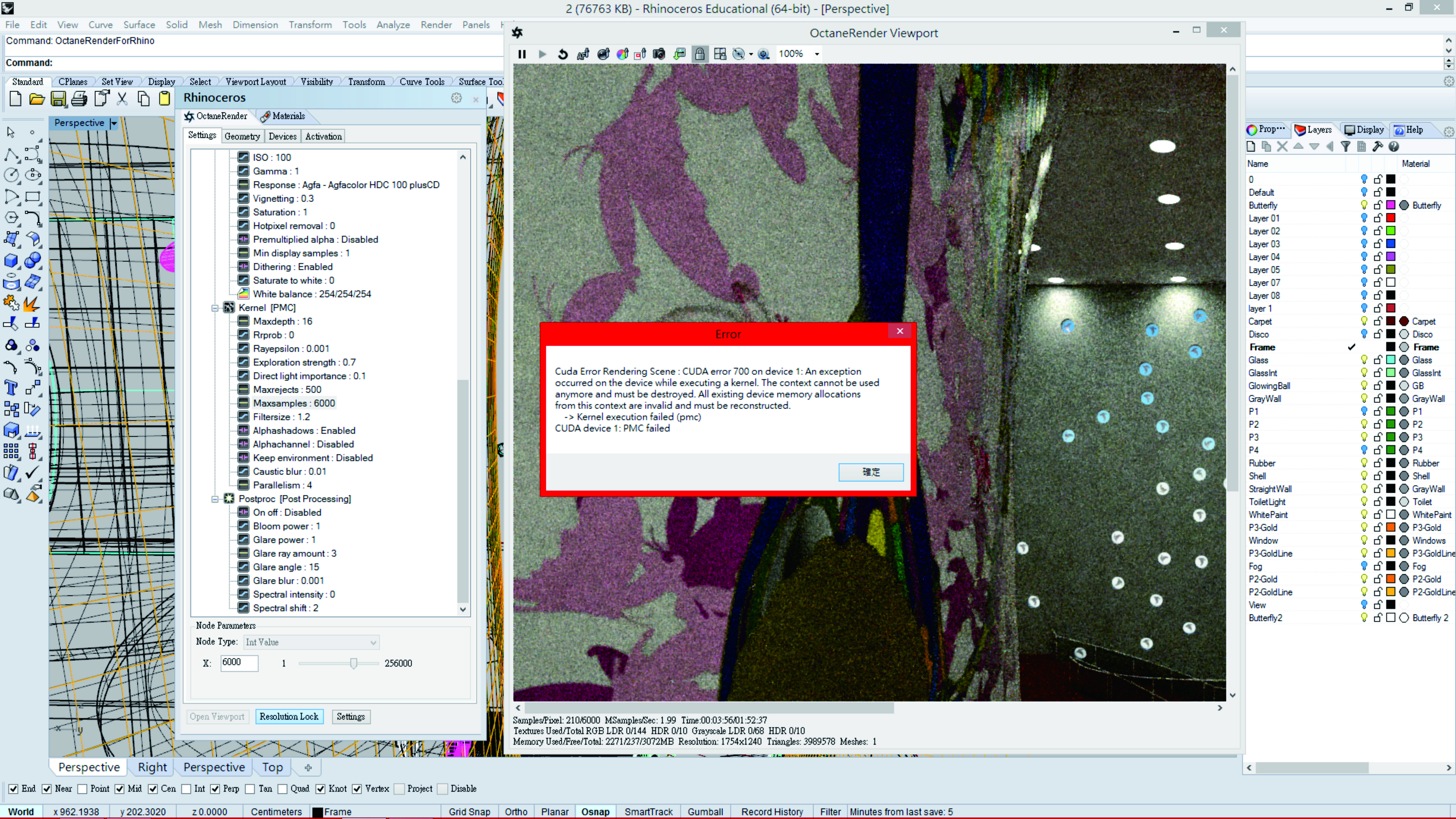

Hello Paul:
I'm currently using the newest version of octane for rhino (1.53.1.22).
Everything was working well, even a bug i have encountered while using ver. 1.50 which pops up on every frame when I'm rendering a animation( Some thread in the forum has the same issue i suppose) is fixed. Yet today I have encountered a problem while rendering with OctaneRenderViewport. A box poped up saying there is a CUDA error 700 on device 1 and the core clock on my second graphic card(which is the so called device 1 I think) dropped down from 1200 to 549 MHz immediately and stucked there. I tried to restart rhino and OctaneViewPort again again but the card is still slowed down and can only be solved by rebooting my system(but the same thing happened again when i tried to render the scene). I'll try to find out if it's a hardware issue while waiting for your reply.
My gears are
I7-4930K @3.40GHz
32GB RAM
2* EVGA GTX780Ti OC@1200MHz w/ 3GB VRAM each
Driver version 337.50
Attached file is the error message. Let me know if you need other information.
Thank you for your time and sorry for my bad english.
Humphrey
face_off
Posts: 15812
Location: Adelaide, Australia
I suspect there is a geometry structure in the which is triggering a fault in Octane. Would it be possible to send the scene to me pls? Then I can save as ORBX and submit it to Otoy for further analysis.
Paul
face_off
Posts: 15812
Hi Humphrey
I was able to load and render that scene without any Cuda errors. I think in this particular case, the scene is sufficiently "complex" that the level of overclocking you are using is too much. If you bring the clock speeds back to normal, then progressively increase the clock speeds when you open the Viewport on that scene, you should be able to find the right level of overclocking.
