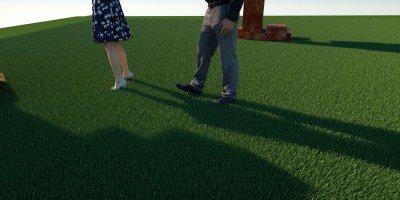

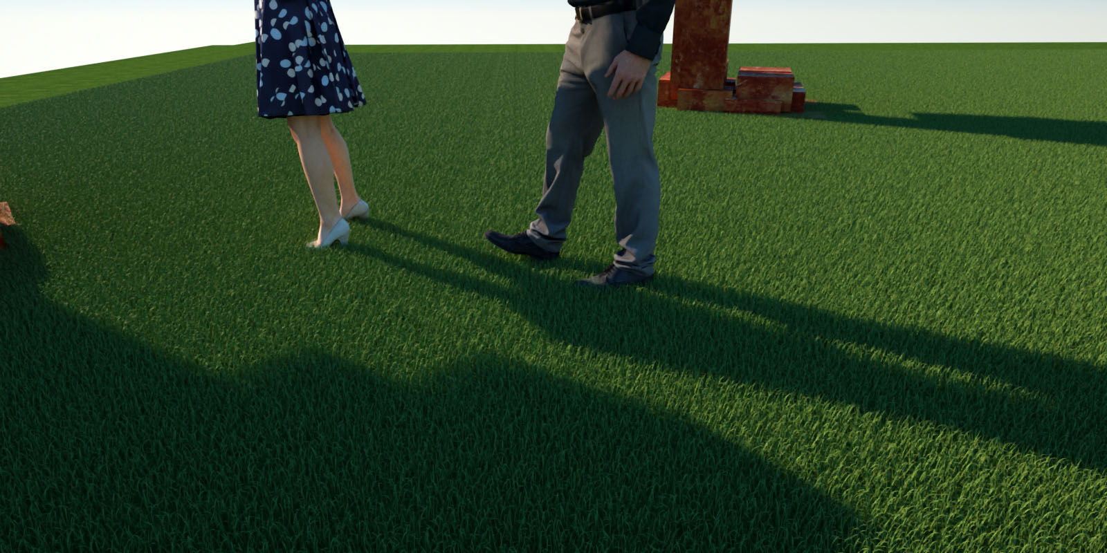

Daniel - What's going wrong?
If you're quite literally trying to just make a 1x1 floor of grass (and you're modelling in metres) you'll want to set PPU as something like 5,000 or more.
So, you'd make a 1 unit x 1 unit surface (or mesh)
Click on it, run the script and set ppu to 5,000 or so (as in, there'd be 5000 blades of grass in that region).
Regards,
Newske
Regards,
Newske
Octane for Rhino | Windows 8.1 x64 | i7-3820 OC | GTX970 4GB OC & GTX 560 Ti 1GB OC | 32GB DDR3

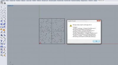

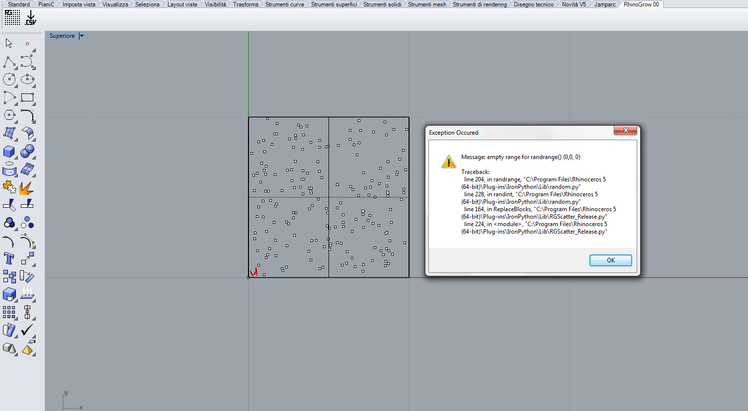

						I tried, but I just get the points, as instances of the block
Now try again and I'll show you the result
