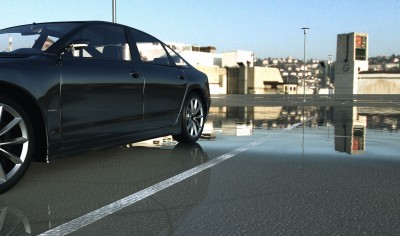

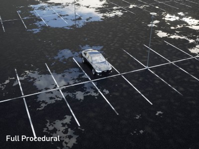

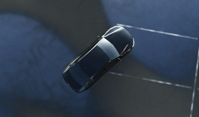

1. I wonder how you make larger areas with texture files (with original Octane settings)? Would you like to give small indroduction?
2. I have tried to do whole thing with procedurals. I added my first drafts. I´m happy with large area but as you said, it´s probably impossible to make smaller details (close ups).
3. What are your first thought of what looks bad and should be improved in my pics?

Postby Builtdown » Thu Nov 30, 2023 1:35 pm
Builtdown Thu Nov 30, 2023 1:35 pm
I did some new testing. Pictures above.
I used image maps and on another version just procedurals.
Image map look good on close view but really doesn´t work from the far. I think I will stick to the procedural version.

Postby elsksa » Thu Nov 30, 2023 2:15 pm
elsksa Thu Nov 30, 2023 2:15 pm
To avoid repeating patterns, there is the Chaos Texture node.
