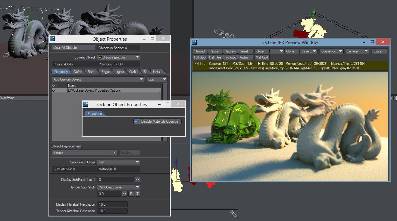

- New objects properties plugin to store current and future octane features at object level
- Disable materials override flag in the objects properties plugin

Do tell, what does this mean? "New objects properties plugin to store current and future octane features at object level"
Can't get my head to make it mean anything :)
juanjgon
Posts: 8867
Location: Spain
There is a new custom object plugin that allow set Octane properties for each object in the scene. Currenty only one option is avaliable, the disable materials override, but in the future here we can have other rendering properties for the object.
-Juanjo
