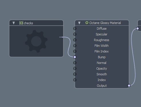

1. Add Octane Override and setup material
2. Click the "Add new subassembly to workspace" button
3. Select the nodes you want to move
4. Rightclick "Move Nodes To"->"Assembly"->the new assembly you created.
I dont think you followed my steps. I specifically moved the override node into a subassembly (I did this by accident) then couldn't get it back out, because once you select it, it automatically sends you back to the workspace (eg. I cant right click on it and choose > move to)
face_off wrote: Works nicely. The only thing I cannot work out is how to connect a node from inside the assembly to a pin outside it - but that's a Modo issue rather than a plugin issue.
Paul
To connect nodes from a sub assembly you need to EXPOSE channels. You right click channels on a node and select EXPOSE input or output. This isnt working with octane channels.
Try this:
1. While in the sub assembly add a channel mod > channel > channel noise
2. Right click the channel noise INPUT and select EXPOSE channel as input... you will see it becomes a sub assembly input
3. Right click the output and choose EXPOSE channel output
If you exit the sub assembly you will see it now has inputs and outputs (pins)
