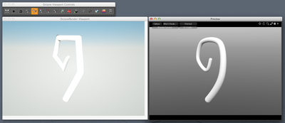

Displacement doesn't respect the Invert setting of a grayscale texture.
Hair rendering doesn't respect guide curve smoothing.
That is a limitation with Octane Displacement.
Octane hair strands are not smoothed. You need to create more control points in the Modo hair strand to smooth it.
