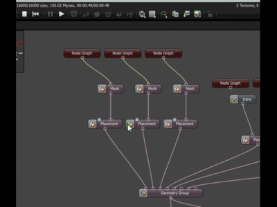

Tugpsx
Posts: 1179
Location: Chicago, IL
Thanks for update, petty issue but when grouping nodes, the connectors become crossed or jumbled.
Grouping issue
Grouping issue
