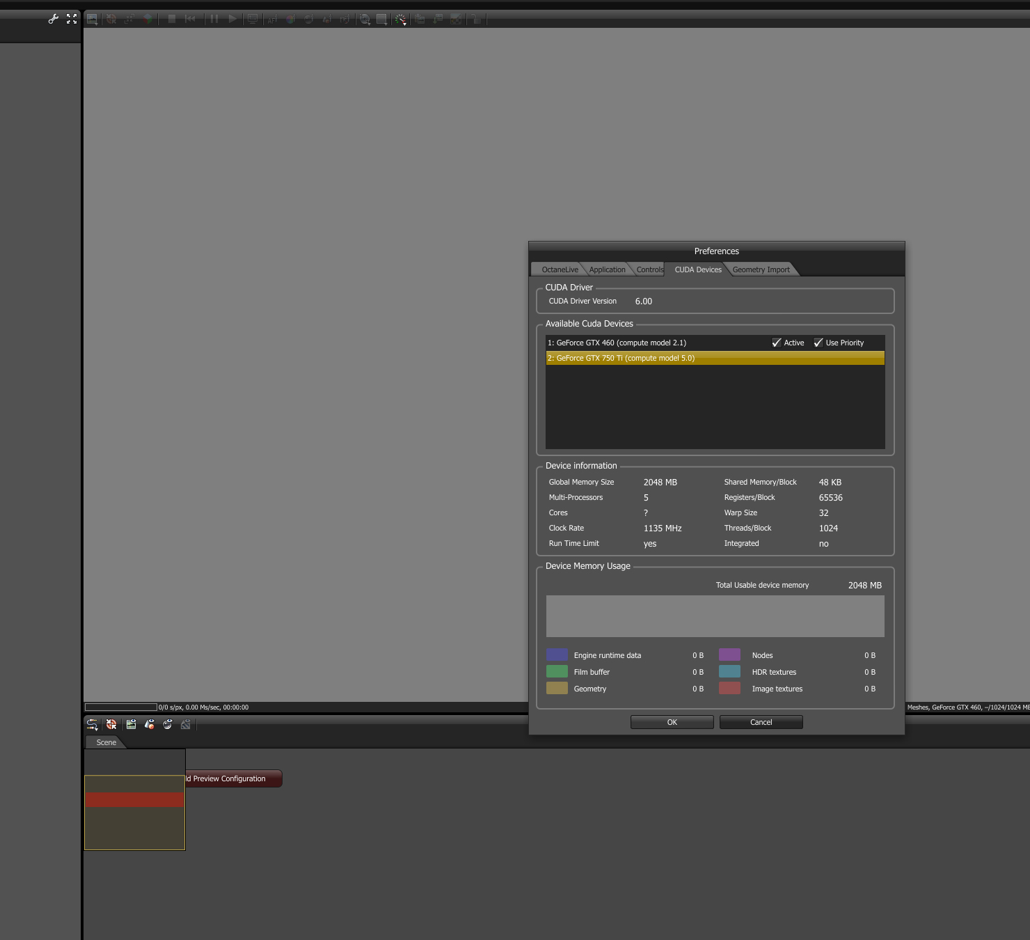

Marcus
Any chance that the next version will give support to running the maxwell gpu's
Just bought a 750ti , primarily to run my new 27" dell Monitor, it might be handy to get the 750ti to do some rendering as well...might as well put it to work.
as soon as it can i'll do some performance tests on it
