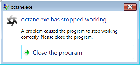

Thanks for the release, looking foward to using the new numeric button, however i can't get this release to run, i also couldn't get release 1.28 to run, it displayed the same error., release 1.29 runs fine.

Maybe it is something in your default scene. Can you go to %appdata%\OctaneRender and rename the defaults.ocs file? If this solves the problem can you attach this file so we can fix the crash?
Roeland
