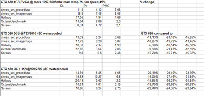

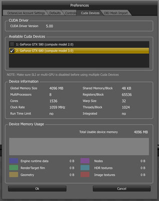

One of my faulty GTX 580 3GB was replaced with GTX 680 4GB http://www.evga.com/Products/Product.as ... P4-2686-KR. The card is very silent. During rendering it works under 45% of fan max speed which makes this card inaudible.
Test scenes were downloaded from
http://render.otoy.com/forum/viewtopic.php?f=33&t=24081
I'm attaching scores compared to GTX 580 3GB on Octane 3.03 and nvidia 306.23 driver, cuda 5.0.
GTX 680 4GB vs GTX 580 3GB - performance test
thanks for this =) really useful - actually looking forward to get 680 'cos I'm getting out of patience for new gk110 unit..(an actually in doubt wheather we even see one on GTX line as 680/690 still holds well in gaming and I'm honestly doubt that NVidia would like to eat it's profits anytime soon..=)
curious, is there any boost from 680 oc? haven't read anything yet 'bout it. the Temps are really promissing (are You looking to put this under WC block? =)

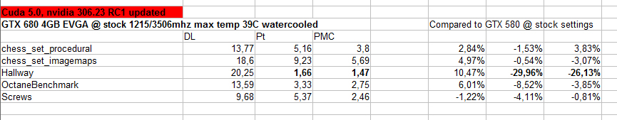

Here are my preliminary tests for watercooled gtx 680 4gb.
Temps: in idle 24C, render: 35C @ stock, 39C - overclocked.
Overclocked in afterburner:
voltage set to max 1.175V
power limit set to max: 138% - octane uses only 75% at overclocked settings. Why?
core clock: 1228mhz (+150mhz)
memory clock: 3506mhx (+500mhz)
And scores are attached. The only strange results I obtained are in Hallway scene.
These results come from RC1 updated version (not 3.03).

thanks for all this info =)
performanse and thermals looking really promissing!

Thank you very much for the results. They are slightly confusing, but interesting nontheless. Could you redo the tests with RC2 (when it's out)? That would be great.smicha wrote:Here are my preliminary tests for watercooled gtx 680 4gb.
