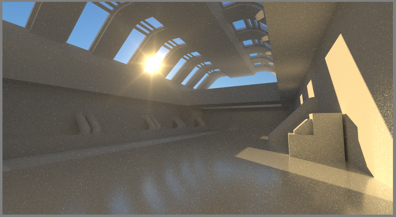

Hello everyone. This is a bug?
Win 8.1/64 | Geforce GTX780TI | Core I7 970 | 24GB
Dmi3ryd
Posts: 233
Joined: Mon Feb 25, 2013 1:31 pm
Location: Russia
Sorry, this is glare power.
Dmi3ryd
Posts: 233
Location: Russia
sun and glare isn't reflect in floor glossy material :((
smicha
Posts: 3151
Location: Warsaw, Poland
Dmi3ryd wrote:sun and glare isn't reflect in floor glossy material :((
Try it on a flat plane.
