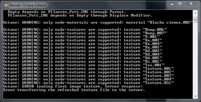

Time after time getting this error (ERROR loading mesh):
Any ideas what may cause this, please?

I had this problem too. I was working on an old project and troubles started when I added lots of vegetation (appended from working blend files) and some new materials. I can't reproduce it now and I'm not sure what fixed the problem, but I suspect that one new material could have caused this. It had box projection and scale transform applied to the texture. When I deleted the projection & transform nodes (and unwrapped the mesh instead), Octane started working again. Before that I also tried deleting all the textures and reapplying them, but I don't know if this actually made any difference...
I tried to reproduce it a while ago - I added the projection & transform nodes to the faulty material, but got a different error this time.

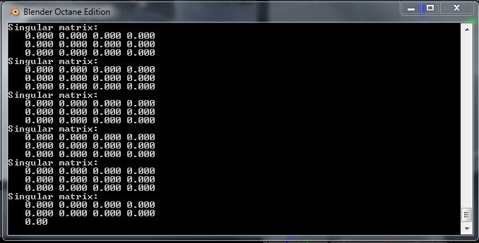

Now I got the "right" error. It showed up out of the blue while I was editing a mesh with interactive rendering turned on, and disappeared after restarting Octane Server.
