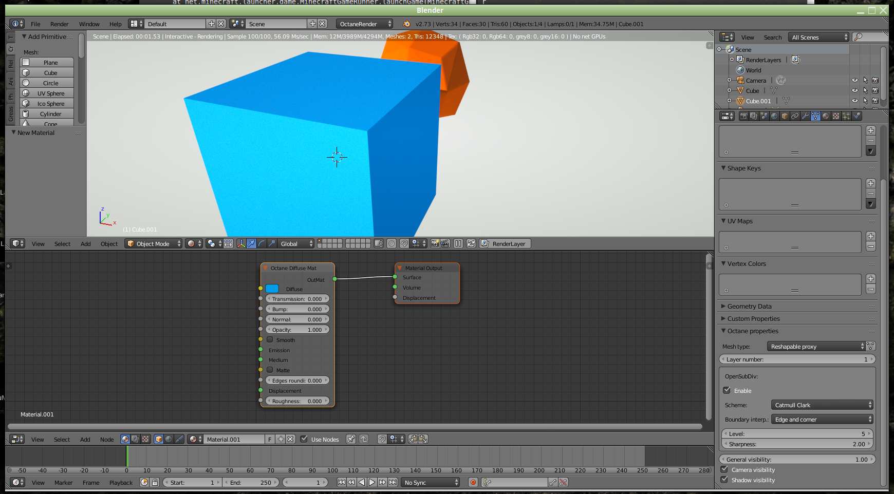

It's working great on my Linux box. I am having a problem with the open subdiv. At least I think it's a problem. To replicate the issue just select a object with several other objects unselected. I then select the object data icon. Then I enable open subdiv and all of the objects become subdivided. I was thinking that the object data only applies to the selected object and not all of them. Can anyone else confirm this? Thanks,
Jason

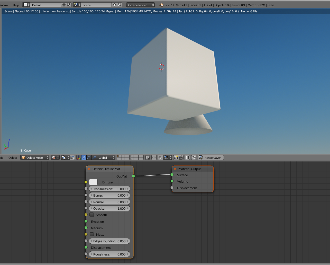

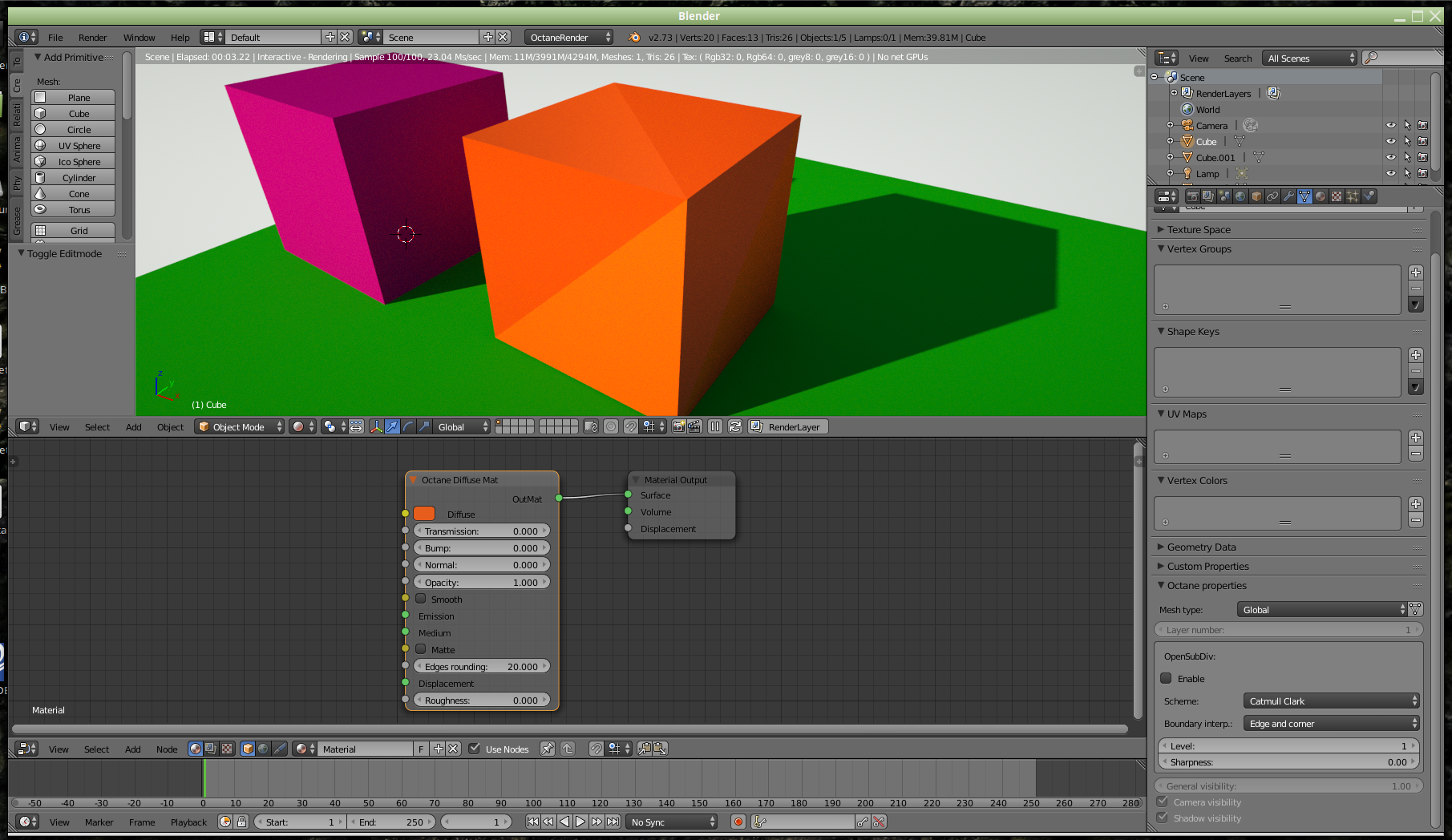

I'm also having a problem with the edge rounding. I was trying it with the default Blender cube which is water tight so it should work?
Jason
Linux Mint 21.3 x64 | Nvidia GTX 980 4GB (displays) RTX 2070 8GB| Intel I7 5820K 3.8 Ghz | 32Gb Memory | Nvidia Driver 535.171
JimStar
Posts: 3846
grimm
Perhaps there is some issue on your side... If so - would be good if you will be able to isolate the reason...
As it works OK on my side:
OpenSubDivided cube:
The same cube with rounded edges:
Saramary
Posts: 147
Joined: Tue Jul 19, 2011 3:42 pm
grimm

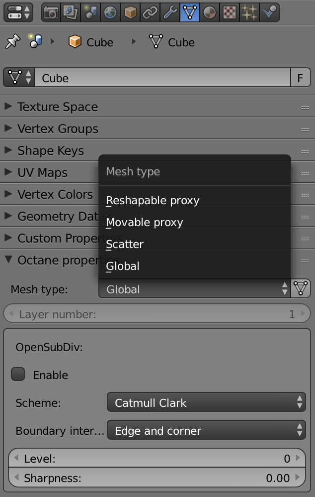

What value have you chosen for the edge rounding? I've tried to reproduce your result and gotten the same image using the amount 1 and higher. But with 0,1 or 0,2 for example everything looks ok. It's it looks logical for me as the edge rounding depends on the size of the object and the basic Blender cube has the size 2*2*2. So, chosing 1, you make it impossible to work properly.
And about a subdiv. Just change the mesh type in object settings and that's it, you can activate subdiv! And it should be shown on preview too.

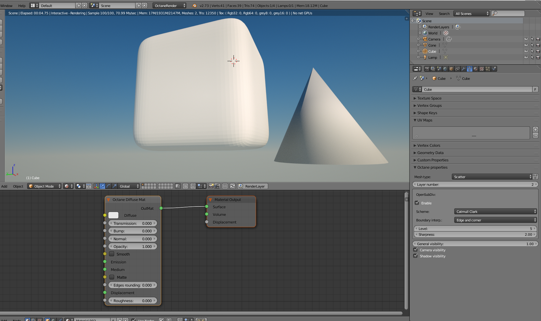

I tried with the same settings in your images. I think I was a bit overzealous with the rounded edges, the setting is very sensitive. Here is what I get, definitely looks better except for the strange rounding on the top edges.
The subdiv does nothing in preview, I tried all the mesh types, only global changes the mesh.

I posted before I saw your post. Yep, I was overcranking the rounded edge setting. The subdiv is still an issue I think. :(

But your orange cube looks like with subdiv enabled... Isn't it?
Got it! Decrease the sharpness. :)

Nope, the orange cube I subdivided using Blender's subdiv modifier. When I restarted Blender it started working, kind of. When I tried to rotate the scene, Blender became unresponsive, this is while the viewport was in render mode. Eventually I was able to get the mode to change to solid and it became responsive again. Then when I went back into rendered mode the subdiv wasn't using the sharpness setting and the cube was a sphere. Then when I started adjusting the sharpness, it popped back into use. So I'm not sure what's going on? :? I suspect it's probably something to do with how I compiled the plugin.
