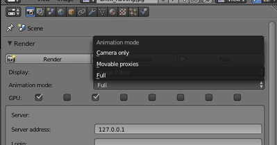

  • If you set "Animation mode" to "Full" - all geometry will be reloaded every frame. All meshes will be recalculated every frame, and all transforms will be reloaded, no matter what for type the meshes have. This is the most simple, robust, but slowest animation mode.
  • If you set "Animation mode" to "Camera only" - all geometry will be loaded in the first frame of animation, and only camera will be reloaded every frame. This is the fastest "camera fly" animation.

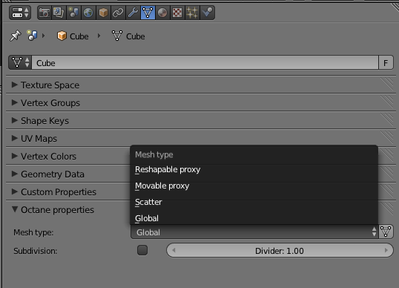

  • If you set "Animation mode" to "Movable proxies", you get most flexible animation mode, but most complicated to tune. In this mode, all "Global" and "Scatter" meshes will be loaded only in the first frame, and will not be refreshed in any of subsequent frames. For "Movable proxy" meshes - only transforms of these meshes will be reloaded in every frame. The more "Movable proxy" meshes you have (in comparison to "Reshapable proxy" meshes) - the faster will be the animation. It is usable if the meshes do not change its shape between frames and do not need to be recalculated by Octane. And for "Reshapable proxy" meshes - both transforms and mesh shapes itself will be reloaded every frame (meshes will be recalculated every frame by Octane). It is usable if you have some complicated animated meshes which change its shape between frames, but the more "Reshapable proxy" meshes you have - the slower will be the animation rendering.

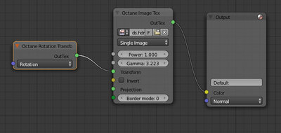

Is it possible to rotate HDR Environment Map with blender octane?
Nothing happens when I change the X and Y values in Octane rotate transform.

Ide wrote:Nothing happens when I change the X and Y values in Octane rotate transform.
Z?..;)

I think there is something wrong with octane rotation transform node when using HDRI maps.
How is it possible to rotate the HDRI map in horizontal?
Try using Translation Transform instead of Rotation. It works for me.
