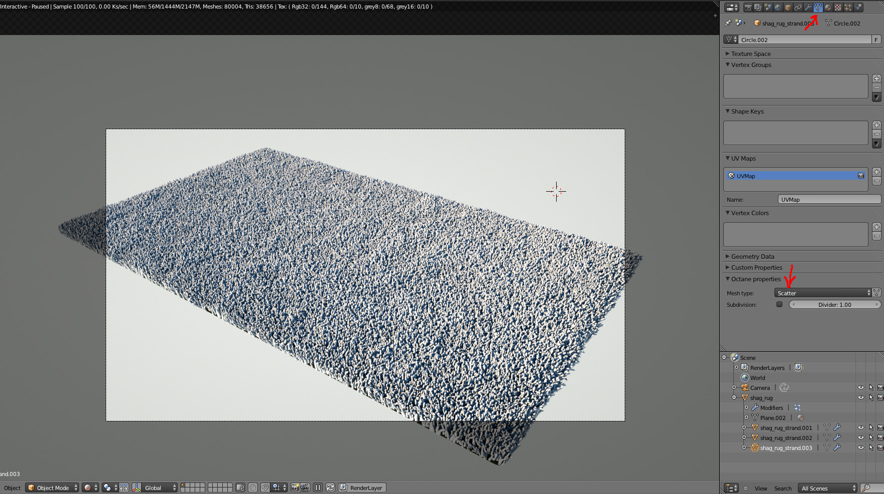

You didn't change a type of your source objects from Global to Scatter. In order to save GPU memory usage you should do it for every source object and for the PS object (I mean the object with ParticleSystem modifier) itself.
http://render.otoy.com/manuals/Blender/?page_id=51

Ow thank you so much!! I didnt know that feature! :D Awesome!
