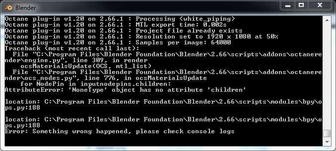

I have a scene in blender that I am having trouble with. For some reason when I export it to Octane it keeps giving an error. I have tried completely deleting the Octane .OCS files and occasionally this will work but the next time I render the problem comes back.
My scene has a number of particle systems and I suspect that one of these is causing the problem.
Here is the portion of the log. Hopefully someone can help. I am running out of ideas.
Blender exporter problem
Hmm, I've just copied all of the visible objects to a brand new Blender project and it seems to have fixed it. Maybe the old project had got screwed up. The dodgy sounding object was a bit of a clue.
