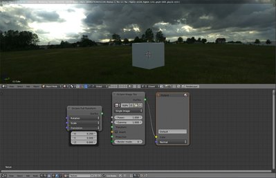

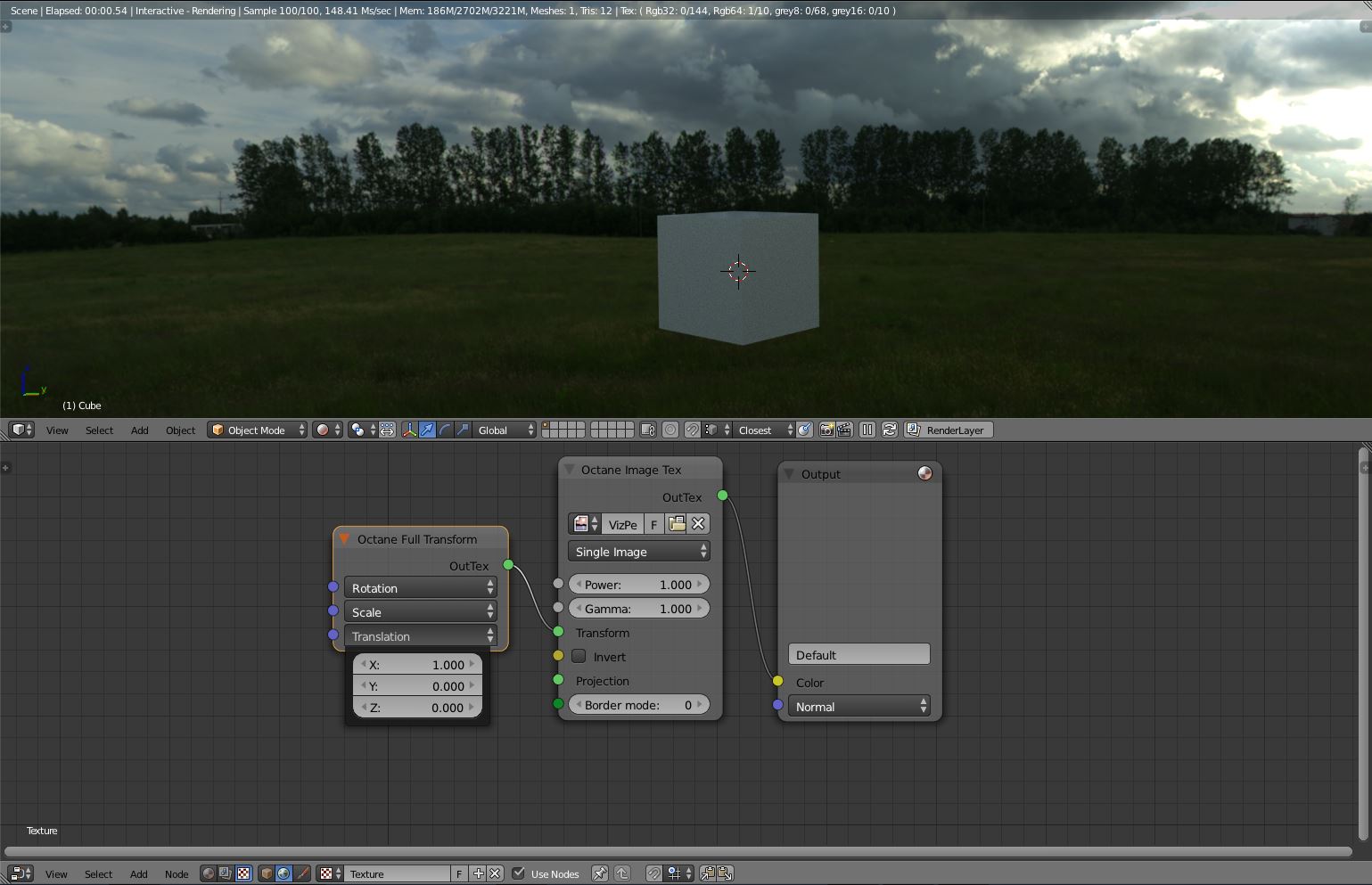

kubicki3d
Posts: 87
Joined: Thu Aug 15, 2013 7:37 am
Location: Bydgoszcz, Poland
Marten74 wrote: You are right about one thing. The translation node affects the hdr map. Only when some value is applied to the Z-rotation though. I can´t wrap my head around what is happening here. The Z-rotation seem to be some sort of multiplication value to what ever the Y-translation is doing. Du you know what it takes in order to only rotate the hdr-map around its Z-axis?
Sorry if I got you wrong, but if you're looking for a "look around" effect, the X-translation is what you need. Value of 1 is equal to 360 degrees, as shown below (I changed only Translation - Scale and Rotation were left untouched).
X-translation = 0
X-translation = 0
X-translation = 0.2
X-translation = 0.2
X-translation = 1
X-translation = 1
