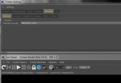

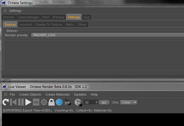

I'm having a rather big problem here... v0.72 (from July) works fine with both my GPUs, as does Octane 1.20a standalone. However, every newer version of the plugin, 0.74, 0.81 etc., has not been recognizing any of my GPUs at all. Nothing. See screenshot. What can be done here? This is the same in R14 and R15.
GPUs are one Titan and a 680. Driver 326.80.

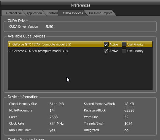

ron908 wrote:I'm having a rather big problem here... v0.72 (from July) works fine with both my GPUs, as does Octane 1.20a standalone. However, every newer version of the plugin, 0.74, 0.81 etc., has not been recognizing any of my GPUs at all. Nothing. See screenshot. What can be done here? This is the same in R14 and R15.
did you make a clean install? What about standalone?

Standalone works fine. I compared the DLLs and they seem to be the same as the standalone, too.
