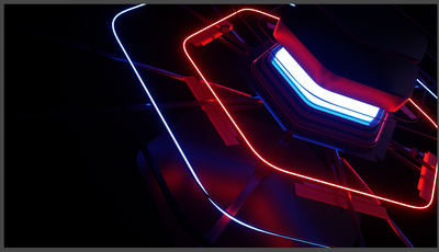

I know this has been posted before, and I looked through what I could find, but still can't find anything to fix the noise in this scene (edit: I understand now that it's not noise).
I just want to have the geometry that is emitting not have noise, but it seems like max samples aren't helping at all. The blue seems much less noisy than the red/orange.
( I tried using a Gaussian wavelength and also tried turning down the power, tips from another thread that didn't reduce noise. )
Thanks in advance,
vmedium

vmedium wrote:I know this has been posted before, and I looked through what I could find, but still can't find anything to fix the noise in this scene.
Thanks in advance,
vmedium
The "noise" here is just totally burned out pixels, i.e. your emitters are too bright.

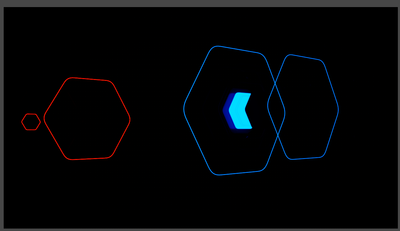

So are you suggesting to turn down the 'power' in the black body emission? When I do that I lose the effect I'm trying to achieve, and lose the blooming in the light itself..
So I understand it's not 'noise' in the literal sense of the term.. It's blown out pixels... How do I go about getting a nice looking and bright emitter without blowing out the pixels?
abstrax
Posts: 5516
Either de-saturate the colors of the emitter, increase the "saturate to white" option in the imager, increase highlight compression or use the bloom post-effect. Or all of the above. Hard to say, because I'm not sure what you want to achieve.

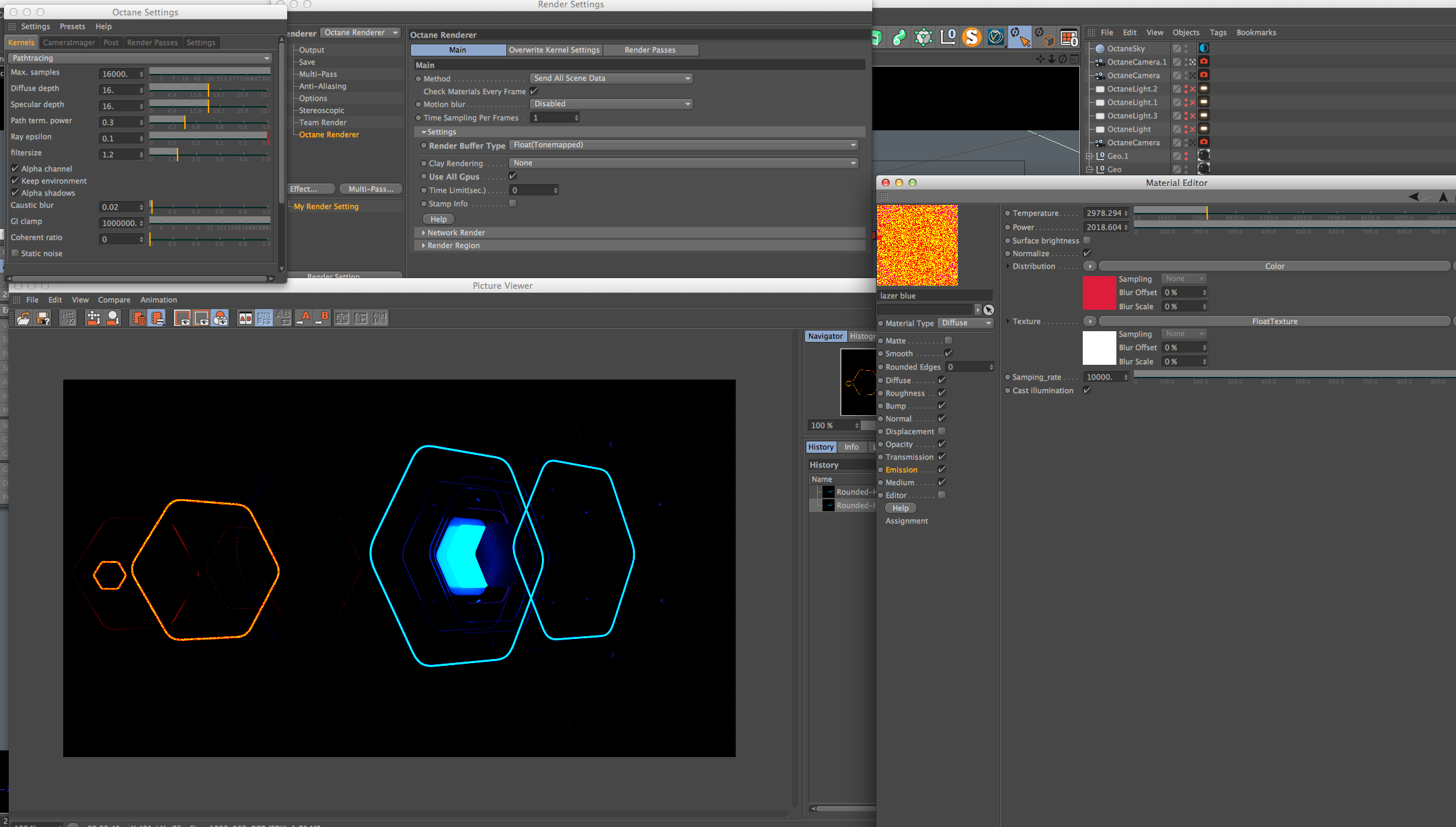

I ended up pushing up
Highlight compression : 20
White saturation to 0.21
post
Bloom to 2
At 5000 samples for path tracing and about 13 minutes I got a lot closer to what I am looking for.
I can sill see a bit of aliasing around the edges of the rounded hex orange light. Is this something I just have to keep increasing samples for.. or more tweaking with the above settings?
Thanks again!
