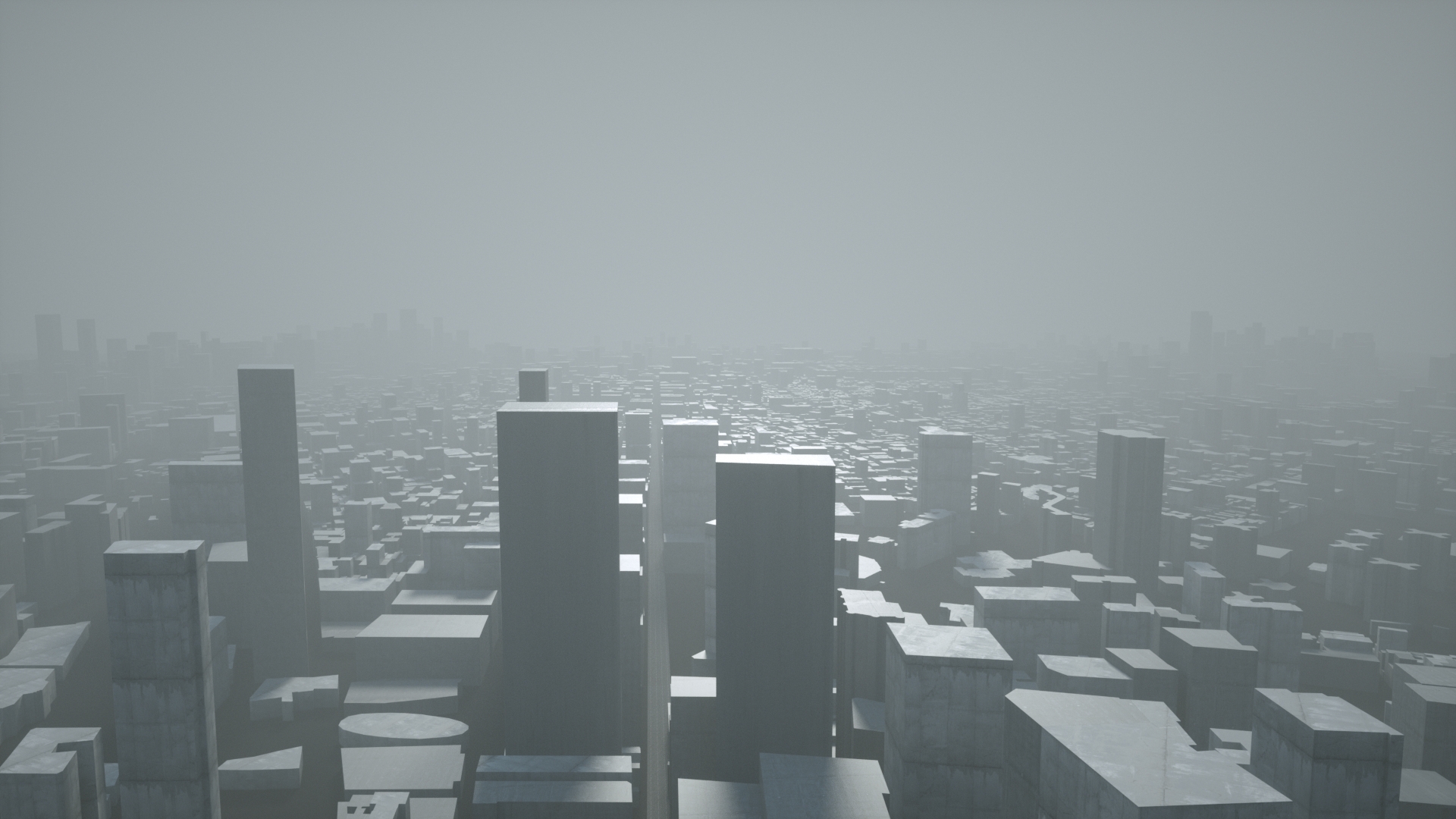

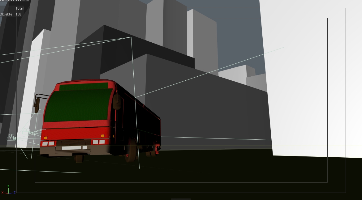

i prepared the scene once again for sharing with other people here .it now includes the complete city (without texures/HDRI) created with the fantastic DEM-Earth_Plugin from Paul Everett)) more or less in realworldscale) and a baked driving-bus-animation (simulated with the amazing Drive-Plugin from Heyne) , combined with different cameras (stageobject-animation) with this animation/camsetup i get some "funky" unusable MB-results with cam2 and cam4 which are directly constrained with the driving bus.thanks in advance to have a look on this MB-issue and once again thank you so much for this fantastic support ahmet! whenever I have to switch the renderer ,I will immediately depressed.... :)

Hi useruser,
can you play and see the strange movement of test text? It's correctly allocated when you stop but else of playing. I think here is a problem with constraints.

yes! something goes wrong. the if you look with a different camera to the "fog_Sphere there is always 1 frame it lags behind the cam-move so this cant be working correctly. i try to set the priority to "generators and/ore bake the cam an the fog_Sphere and look what happens.

DEM-Earth works right out of the box. you evenb dont have to convert standard-mats (created by Dem-Earth) the only thing that does not work is the brandnew Dem-gradientmat. you have to manually setup your own octane-gradient because the transition does not work if you tray to convert the native-gradientmat to an octane-mat.
btw. i fixed all problems with fog and motionblur with baking the constrainted cams. the stage-object does not work properly but this is not a problem for me personally. just render every came separatly, bake constrained cams and start render. :) so i will use the stage-objekt for tweaking/adjusting the whole camera-animation only.
