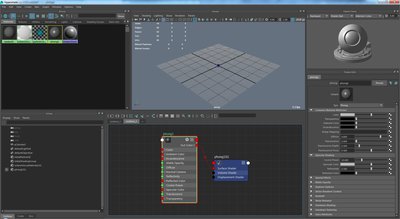

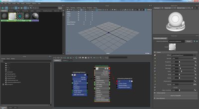

Hi Jim - Thanks for Maya 2016 support! However, I'm noticing some odd behavior in the Hypershade. I set up a simple Octane material with a file texture, like this:
Then:
1. Change a float attribute (e.g., set material's Specular to 1.0).
2. Click on another node.
3. Click on the original node. The float attribute is reverted back to what it was before step 1.
If I click on the "Toggle between Lookdev/Attribute view" button in the Hypershade's Property Editor before step 1, it seems to work fine. It seems like maybe Octane isn't "remembering" changes in Lookdev view, but it does in Attribute view.

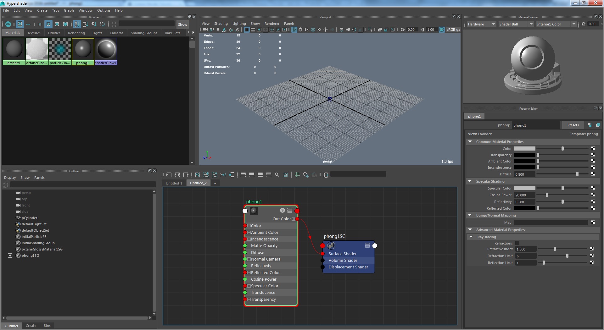

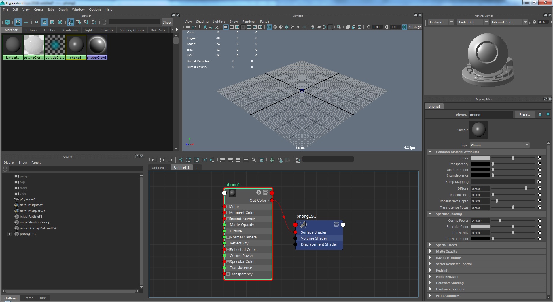

This is related to a second issue, which is that I can't seem to tell if an Octane node is in Lookdev or Attribute mode, because there's no visual indication of a difference. The standard Maya Phong looks like this in Lookdev (lower right):
and this in Attribute view:
Hope this could be a quick fix! It's hard going back to the "old" ways after working with the new Hypershade...
