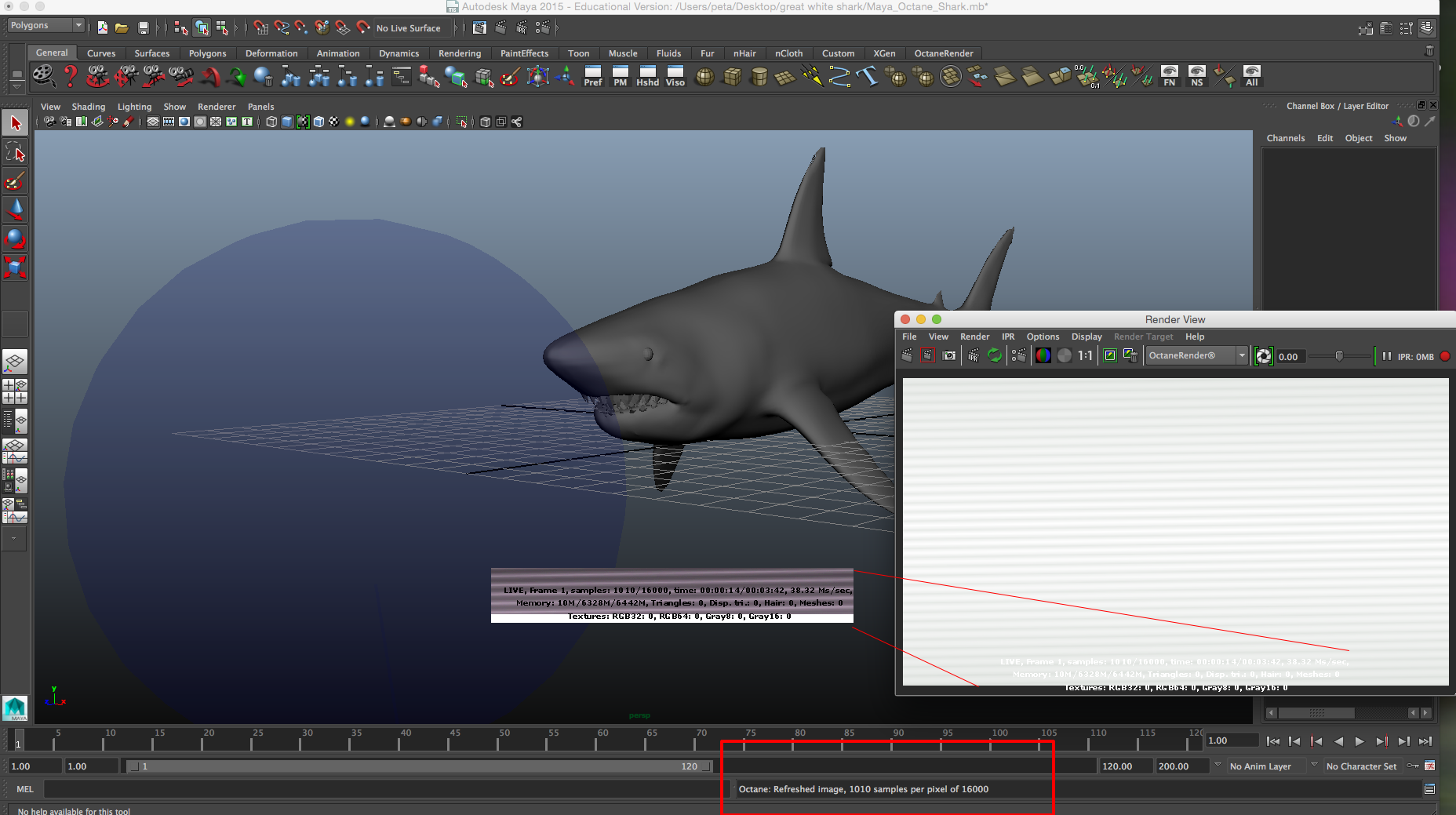

Gidday Jimstar
Your Installer worked fine with on
Maya 2015 SP5 on
Mac OSX Yosemite 10.10.1
Web Driver 343.01.02f01
CUDA 6.5.25
One Titan Z
I was able to get the standalone 2.16 and 2.15 running on my Mac OSX and can render on both of these.
When I render in Maya using Octane (Activated and shows samples processing) I get a white screen.
Having both 2.16 and 2.15 in the applications folder.... could that be it???
Peter
JimStar
Posts: 3852

Here ya go

p3taoctane
Posts: 1418
Joined: Mon Jan 25, 2010 12:53 am
See anything in here JimStar that lets you know what it might be?
Peter
JimStar
Posts: 3852
Nothing bad in the log. I still think it may be some issue between plugin and Octane OSX SDK... I'm on vacation right now, so will check it after I be back.
